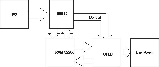

Yes, i post for you a my block diagram. On PC i can type any character and them display on led matrix. I fed data to colum and scan row because there are very lot of colum.
On PC, i can type any characters and display them on led matrix. Control bus controls CPLD take data from RAM62256 when 89S52 transmit the last data.

Block
I'm sorry, i'm very busy and i'm late. Now i post my block, Can you help me?
Thank you very much!

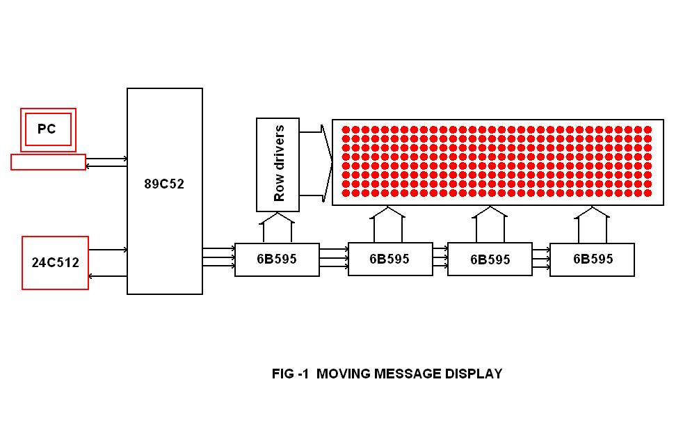

I have studied you block diagram and i Think that there is no need for the CPLD and the RAM. The function of CPLD and the RAM must me implemented by software routines in the 89C52 microcontroller . the attached figure shows a more simple moving message display. In this block diagram a serial EEPROM (24C512) is used to store the messages data send by the PC. The microcontroller reads the data from the serial EEPROM and convert it to serial then shifting it to the shift registers with row select data as shown in the block diagram
