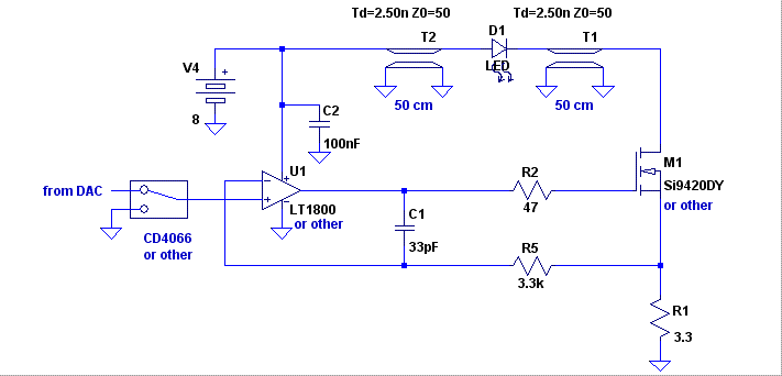

The amplifier is too damn fast. I have stopped the resonance going up to 30V by putting a 1nF cap between the output of the AD8061 and the inverting output (inplace of the 15pF cap that was already there). All I am left with is one 30V spike when the FET switches. Any ideas on how to get rid of this? Or is it just a snubber circuit. Its just that the PCB is designed and I don't want to do any crazy stuff.

The circuit was simulated before hand (not by me) but by someone who is no longer contactable. I breadboarded this before I actually made the circuit and although there was a wee bit of ringing around the FET switching edges on the breadboard, this was small and thought just to be because of the inducatance in the wire interconnects. This would disappear when on a PCB. However, the ringing turned in to a 30V pulse.
I slowed the amp down by replacing the 15pF cap with a 1nF cap. I also added a 100ohm gate resistor to the FET. The only thing I am left with is a ~15V pulse on the FET switch on and off. I am analaysing the spice simulation at the moment.
FRIED, you said you simulated the AD8061. What did you mean that the amp fell over without any inductance? In my simulation, without any inductance, there are spikes but the amp doesn't go in to resonace.

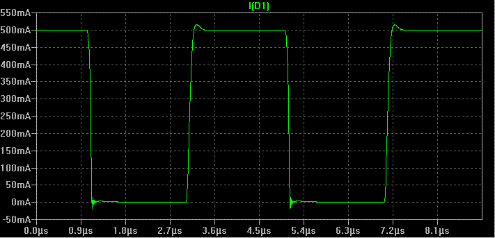

Perhaps you should consider getting rid of the FET switch and doing the switching in front of the op amp. See sim results below. As you know, the hardware may behave differently.
I show switching with an analog switch. You could do the switching digitally in front of the DAC, which would be preferable if your DAC is fast enough.
