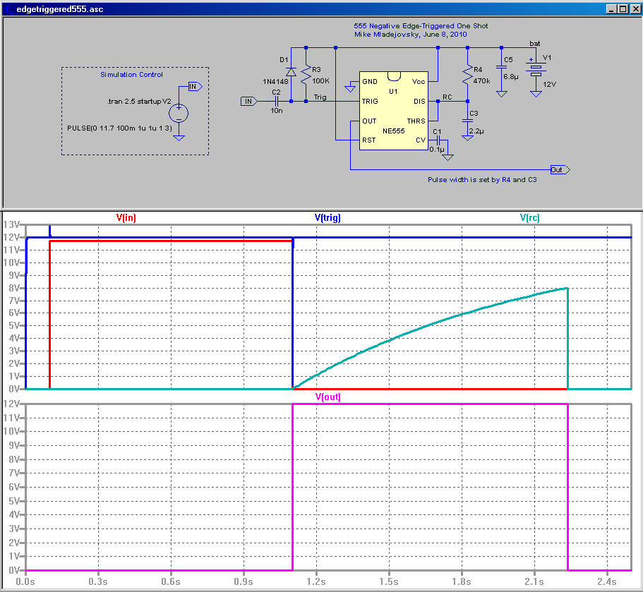

Here is one way to do it. It makes clean pulses on both the rising and falling edges of a square wave, in this case created by a single pole single throw switch.
LTSpice has a voltage-controlled switch for simulation, so V2 is flipping the switch back and forth for the simulation.

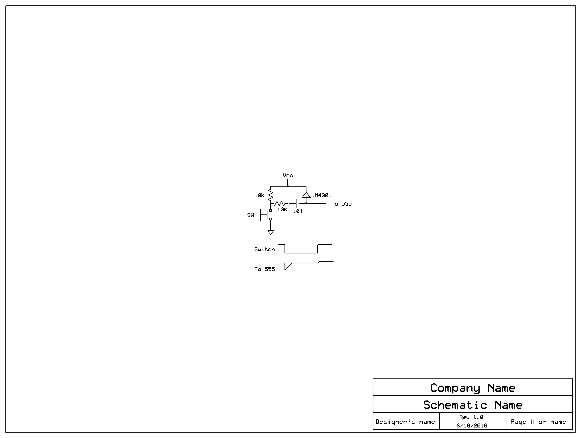

I know you said you wanted a pulse in both directions (switch on and switch off). But just in case it works like a tv remote (push on, push off) here is the circuit first mentioned.
Both works
Adding a 100 micro Farad cap between the switch and 0V on pin 2 worked and the 2 resistors with .01 micro farad and diode worked also. The second one has a much better recovery time. I wonder which one is better and is the least drain on the battery while the switch is on?
Thanks again for all the help.
Mike
Post a schematic.
Post a schematic.
Bychon suggested adding a capacitor to the switch. The schematic posted here is the monostable I made, but I added the 100 micro Farad capacitor to the circuit and indicated with an arrow per the suggestion from Bychon. The other circuit was posted by ronv and a schematic is included with the post above. I connected the output of that circuit to pin 2 of the 555 in this circuit. Both ways work, but the ronv circuit has better recovery. I wonder which is more correct and is the least drain on the battery while the switch is on.
Thanks,
Mike
Ok, look at this. Replace the pulsed source with your 10K pull-up and switch to ground.
Yes. The current will be I = E/R = 9/10000 = 0.9mA. The quiescent current for the 555 is about 9mA, so that is by far the dominant power drain. If this is too high, get a CMOS 555, and replace your pull-up with 100K. Now the 9V battery will run for a couple of weeks instead of a couple of days :p
Thank you for all of your help. I really appreciate it. I will assume that the .9ma is better than the other 2 circuits that have been posted. In future posts, I will remember to include schematics to get good answers quickly.
Thanks again.
Mike

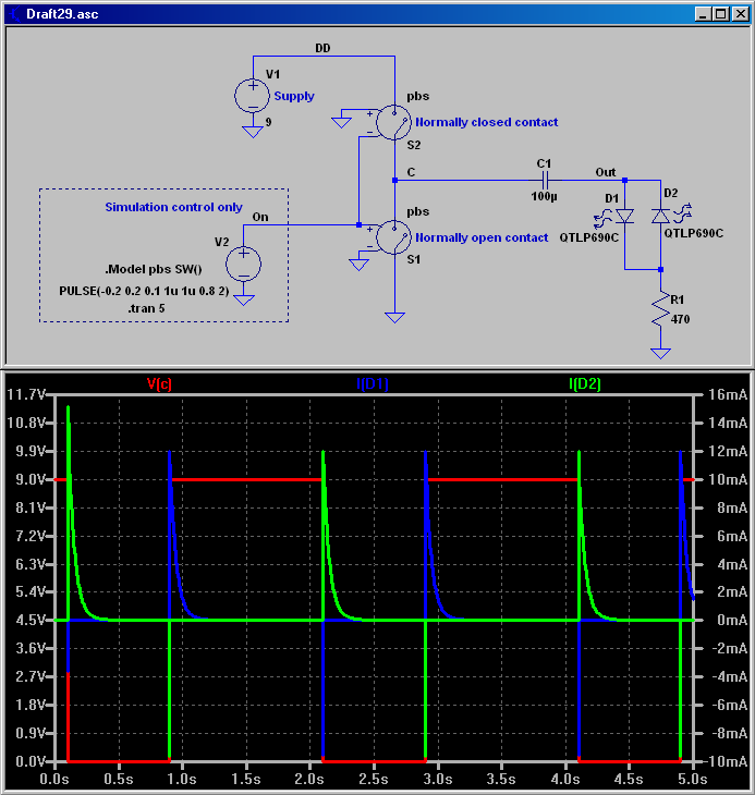

If you wire the Normally Open to the positive supply, the Normally Closed to ground, connect the Common to a capacitor-resistor differentiator, then there is no quiescent current. This might work if you can deal with the bi-directional current pulses. See Draft28
You could use steering diodes (or LEDS) to separate the output pulses. In Draft29, the LEDs flash alternatively each the switch moves either way...
