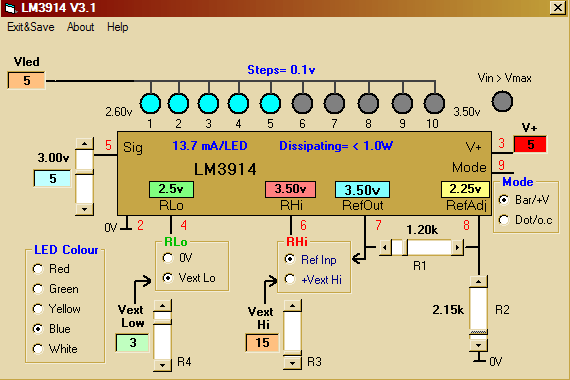

You could use the 1V control pin [555] differential voltage to drive a LM3914
Like this image.

Your mathematical electronic software shows values for
a range of voltage from 2.5 to 3.5v. How about the values
if I only want a range of say 2.75 to 3.25v, so it will be
more sensitive than the servo (I don't want it to take a
full swing of the servo to light the tenth LED, I want the
LEDs to practically all light up when activity is just beginning).
I was also wondering, the values you show for R3 and R4
(15 and 3 respectively), what are they, R in ohms or Kohms?
The software shows them as Vext Low and Vext High (pins
4 & 6), so what do I do with these pins?

The values of the voltages on the LM3914 can be set to suit your Vc[pin5/555]
The value of R4, which would be a Vpot in the final circuit would be connected to REFout pint 7 so that the 2.5V on pin4 could be adjusted to suit. R3 is not used.
The intention is that with a centre point of say 1.5mS == to 3V on Vc, LED #5 would light, as the 1.5mS period increased the the LED's 6,7,8,9,10 would light.
LED10 would indicate 2mS and LED1would indicate 1mS.
I would suggest BAR node for the LM3914, so for 1.5mS, LED's 1 to 5 would light.
If you want to go this way let me know and I will post a circuit diagram.??

You said that the Vc control voltage to the 555 varies from 2.5 thru 3.5v, which corresponds to 1mS and 2mS.
If the Vc was connected to the input pin5 of a LM3914, set for 2.5Vlow to 3.5Vhigh, in DOT mode, at 'rest' ie;say 1.5mS then LED#5 would be lit
What would be ideal values for the meters, to cover a 0.25v range???

I have built the meter, and taken readings off of pin5 of
BOTH 555s (astable & monoastable), but any fluctuation
(even full scale) of the servo's motion does little to nothing
re moving the meter. Either the meter needs to be much much
more sensitive, or I do need the LM339 comparator likely
with GP transistors to drive the LEDs...?

The Output pin looks like what I would want to use, and with the centering
pot I use to center the servo, the reading varies +/- 1.0mv. Therefore, I
would like the range of the meter to be about 1.0mv itself, so I would get
signals from about a half a mv on either side, and I would (of course) need
to be able to adjust the meter's "centering" (for when I adjust the servo).
This sounds likely impossible, and I do have another idea of how to do all
of this, which may not be viable, so I'll wait and see what you think about
the 3914's total range of about a mv (or a very little bit more than that!).
Thanks.
From a quick look at your +/-1mV change, I would suggest that it needs to be amplified to suit the LM3914.
An amplification of 100 would raise the signal change to +/-100mv
The amplifier OPA output could be set to a '0' centre voltage of 100mV, with a swing of 0V thru 200mV.
The centre '0' of +100mV would light LED #5 and less than 100mV would light LED's 4,3,2,1,,, greater than +100mV to 200mV would light LED's 6,7,8,9,10 as it increased.
The 0mV OPA output would require an ideal OPA whose output could go to 0V, most OPA's cannot when used with a signal supply voltage.
To overcome this OPA 0V out requirement, the OPA could be set for +100mV out which would represent -1mV [ +100mV after amplification] and +200mV would represent 0mV and 300mV == +1mV.
The thresholds of the LM3914 would be set as Vlow = 100mV and Vhigh = 300mV.
This may sound a little complicated , but in the actual circuit its quite easy to achieve.
If you need a circuit diagram let me know.?

I wish for the meter's full range to vary by 1mv, at approximately
the timer's "servo center" output (188mv), because the timer always
generates that reading when the servo is still (so, full range of
meter between 187.5 to 188.5mv). Using the 100:1 on an amp
makes this almost 18v...? Choose an amp that could do that !
I'm not that familiar w/ op-amps, so I don't know which one or
how I would wire it, would be best for this scenario.
I would also like to be able to adjust the op-amp's gain as well
(maybe by 10-20%). So, an 80:1 or 120:1 range would be nice.
Since I'm utilizing bar-mode, I'll likely set the meter at one LED
on, and just let the "motion" (the timer's output) drive the meter
on half of it's motion (since when the servo moves it goes back
AND forth). Sooo, a range as stated above, but I won't have to
center it's mid-scale to my servo center voltage, I'll simply center
the meter's bottom scale (LED#1) to the servo center voltage.
This way, I'll get a broader illuminosity over the range of 1mv,
and use less power, and keep the regulator cool as well (the 3914
is actually driving two paralleled LEDs on each output, so when
many of the lights are on for a while, it tends to get pretty hot).
Thanks !
