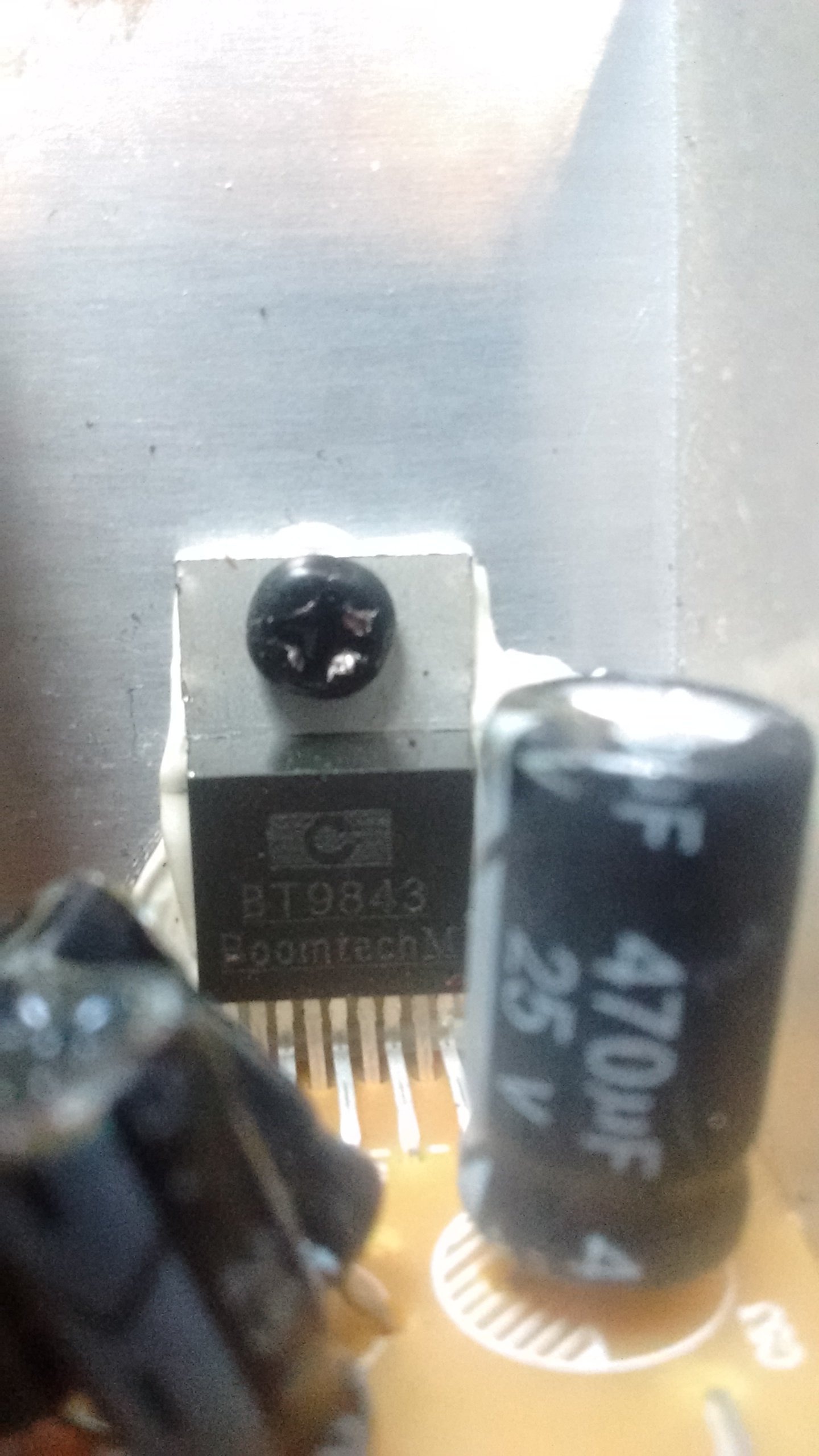

The power supply of my Creative A520 speaker system got nuked in lightning. I tried an external adapter 12V/1Amp and it works with occasional volume loss during heavy bass. I guess the adapter is unable to supply enough current.
I am trying to repair the power supply but cannot figure out the values of the burnt parts.
I can see two resistors and a zener diode as burnt:
Please help me figure it out.View attachment 94210

A few amplifiers are "class-A" and are actually room heaters and they draw maximum power supply current all the time. The Creative amplifiers and most other amplifiers are class-AB or class-D that draw only as much current as the output power needs. Your Creative speaker system is rated at 37 Whats when it is blasting severe distortion louder that it can play normally. That is 37/12= 3.1A. It would draw 0.3A when not playing loudly.
We do not know what is causing your static noise or if it will happen again.
It sounds like your bass control is worn out and needs a replacement. The small woofer and low amplifier power does not produce much bass anyway.
