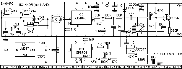

hi, I want to know if somebody have a scheme of a cristal controled FM transmiter that can be used in the LINE OUT of the computer sound card.
Thanks , sorry my english.....
xtl FM-TX
Here is a commonly known FM transmitter using Crystal Control for 88-108 Mhz off the Web. I guess any Low Level audio input is ok. Les.
