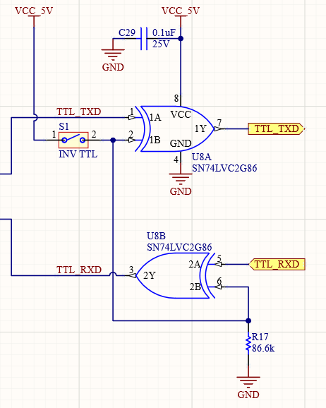

I recently did something to perform a similar task on a product I designed for work. I needed to control the inversion of TTL signals with a single DIP switch. I decided the simplest option would be to use two XOR gates. In my case I used a SN74LVC2G86 which is a dual XOR gate in a single VFSOP package.
Unfortunately this is limited only to digital signals, not analog.

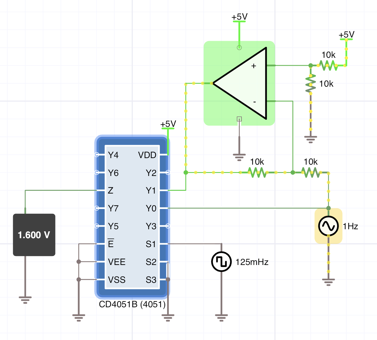

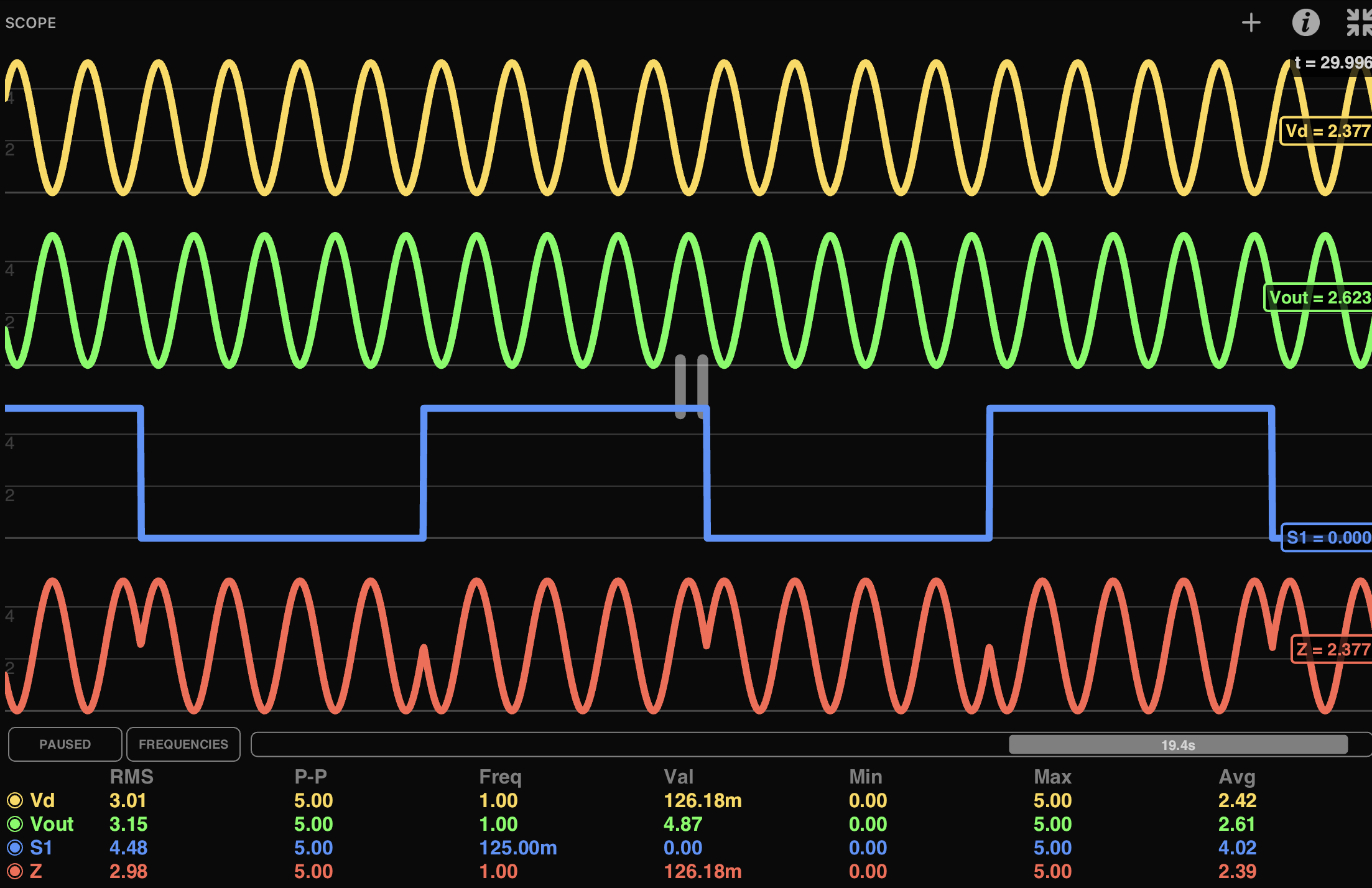

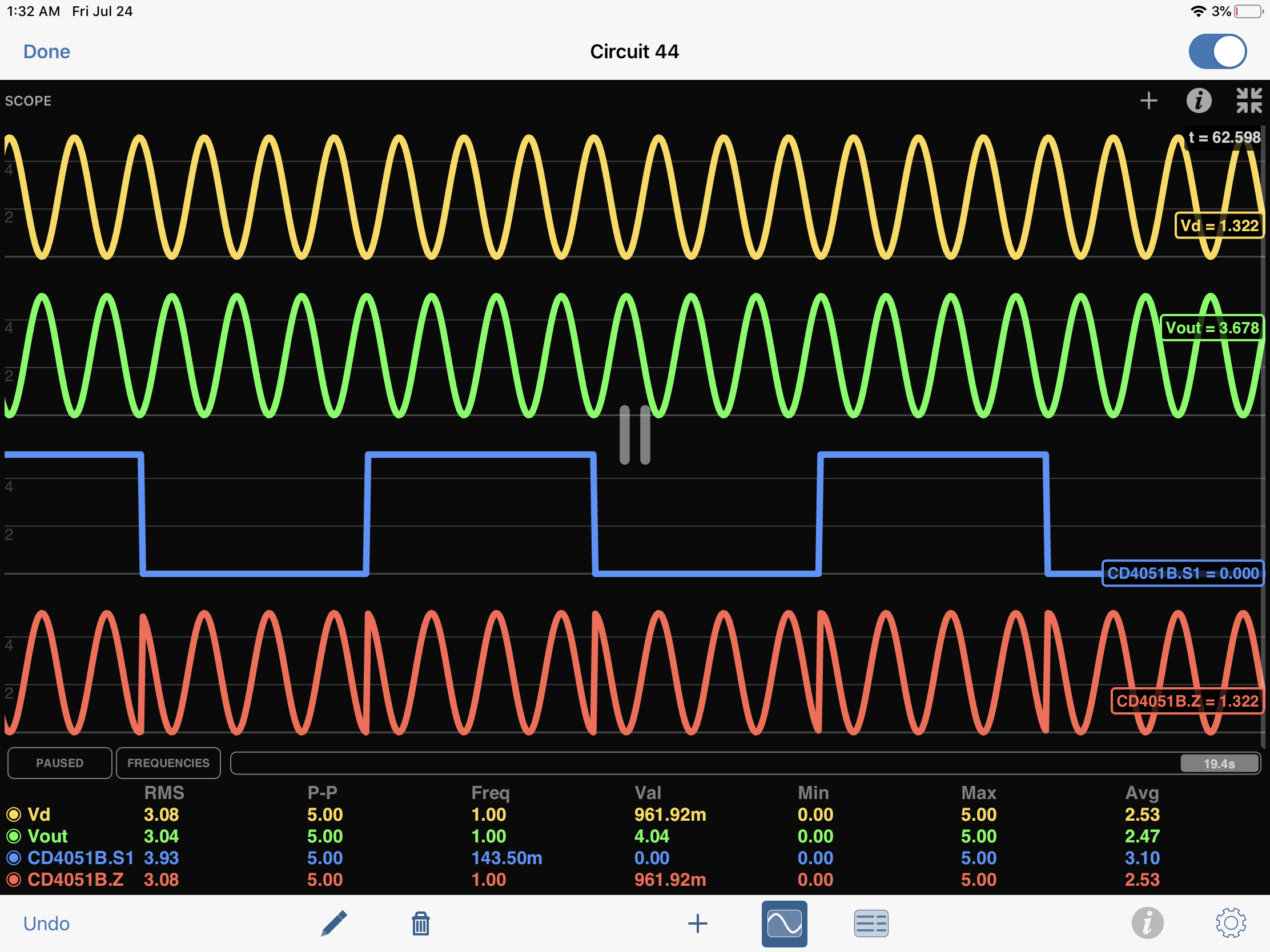

DerStrom8 was on a good track but he didn't find the right old chip. An analog multiplexer/demultiplexer csn do the job. The op amp inverts the original signal (yellow) to make the green scope trace and both are fed into the chip at Y0 and Y1. The status of pin S1 (blue trace) determines whether the Y0 or Y1 values are sent to the output (pin Z in red).
No more concern about delicately balanced resistor networks. Also, the chip can handle negative voltage inputs & outputs but you'll need to supply a negative voltage on Vee and to the op amp negative power rail.
NOTE: in your scope and my scope, it looks like the signal just mirrors and starts going in an inverted pattern. That is because the control signal is a Frequency multiple of the analog Signal and the inversion always happens at a zero-cross. If the control signal is random, in my circuit, it can flip the voltage of the 5v p-p across the 2.5v bias immediately. That is, if the signal is at 1 volt, it will immediately flip to 4 volts (Which will look like a vertical line on the scope). See second set of traces.
I'm sorry for the right to left schematic but the pins on the logic chip don't accommodate that theory.
