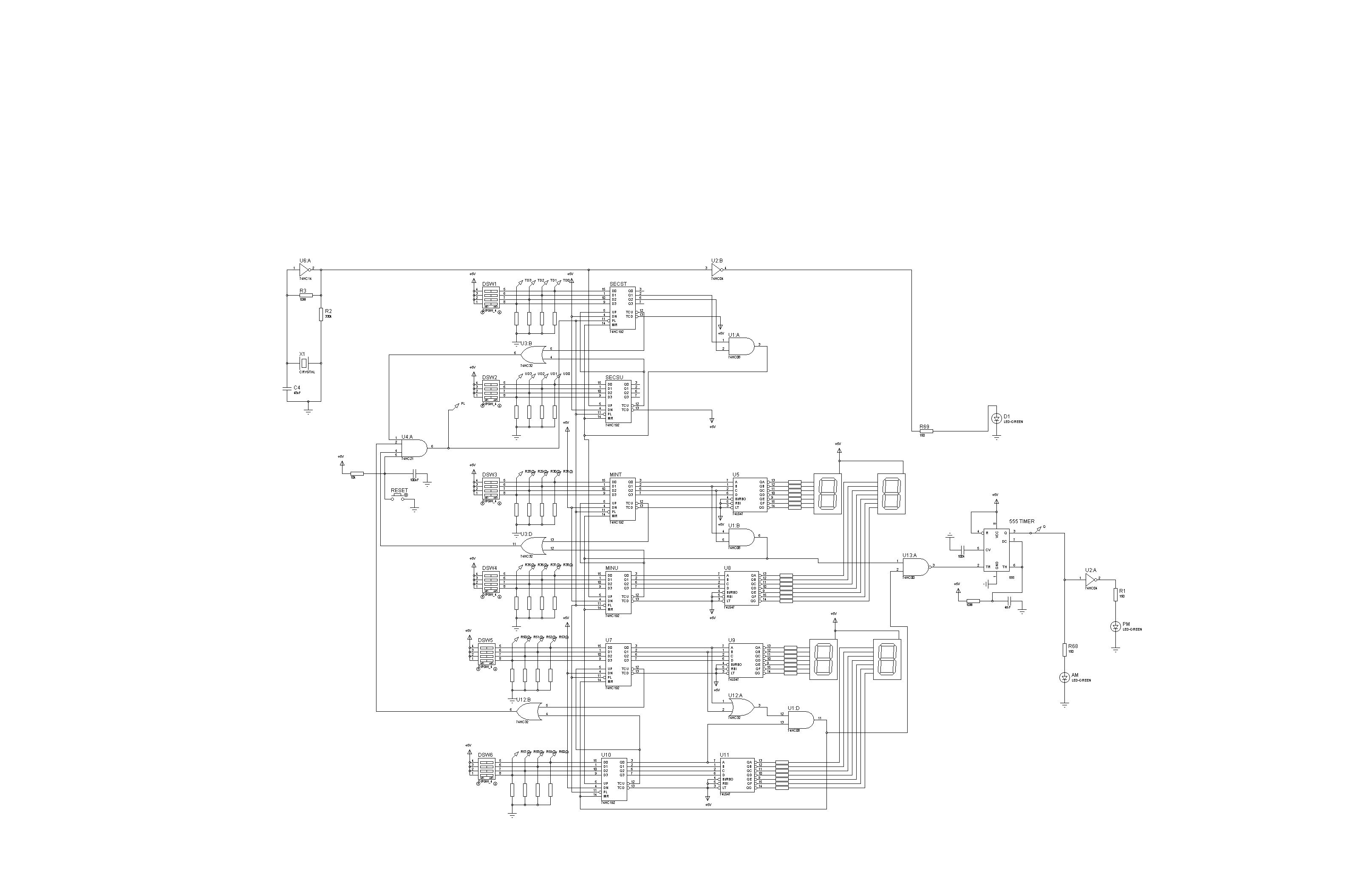

Hi all, I am trying to design a crystal oscillator to give my digital clock a frequency of 32.768kHz. I have tried many design such as the 4061 IC, Pierce Oscillator, Series RLC circuit but none of them work. Does anyone know how I can design my final part or at least give me some help?? Please find attached my digital clock design**broken link removed**... I must connect my oscillator instead of the temporary clock connected to pin 5 of the 74HC192

I have run the simulation using Proteus. I have arranged the error it was giving me. he error was brought up because of problems with the NOT gate since it was of a different family. However the oscillations are not produced. The output from the oscillator always remain low and therefore nothing is driven. I cannot afford to build the circuit and hope it works as I am going to built it on a PCB. There must be a combination of how to interface a crystal oscillator with the 192...

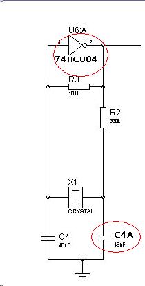

i have simulated the oscillator... now the only thing i have to do is to find exact values for capacitance and even resistors since the accuracy of the crystal oscillator can be adjusted by these values. I have not used a pierce oscillator. I have used a combination of an RC circuit with a schmitt trigger... Please tell me if you need to see the circuit I built.
Yes, please post the schematic.
Also bear in mind that there are some circuits which work well on a simulator but either don't work or perform extremely poorly in real life.
What's the value of C4?
You need to be sure that it's the crystal is actually doing its job and resonating otherwise you could've just designed a glorified RC oscillator which I think is the case here.
The resistor and capacitor values should make little difference to the frequency of a crystal oscillator, try changing them and it shouldn't make much difference, for example, if increasing the value of C4 by 20% greatly reduces the frequency then the crystal isn't doing anything.

My company makes crystal oscillators and I design them. I've only tried simulators a couple of times, and at best they show you that an oscillator will oscillate. If you are lucky, it will tell you the frequency.
What it won't tell you is the load capacitance of the crystal that is needed. You can forget startup-time or pulling range (for VCXOs). The model of a crystal as a series combination of an inductor, a capacitor and a resistor, with as capacitor in parallel with the lot, doesn't simulate spurious response or overtone oscillation.
Oscillator start up is often thermal noise that is amplified by the active element and filtered by the crystal. That is very, very difficult to simulate, and needs a very small time resolution and a very good voltage and current resolution, and the simulation needs to run for the time of many thousands of cycles. In real life, 32.768 kHz watch crystals take up to about 3 seconds to start.
Simulators are good for digital circuits. They can be used for analogue circuits with a bit of care, but they are not designed for working with crystal oscillators.
with reply to hero999, i havent replied because i am trying to find a different way... i am not ignoring you if that is what you're saying... i know what you meant when you said that the oscillator will also work without the crystal... but pls note that thats a bug from my somulator since the problem also occurs when removing the crystal from the 8051 microcontroller... it will still work. I have tried what wade told me but the 74HCU04 is not available in the simulator... now... for hero 999... if i set up the circuit using the pierce oscillator or the circuit wade has showed me... are you saying that in practice it will work where as in the simulator it will not??
to diver300... do you think that in reall life, the pierce oscillator using a 74HCU04 will work in praactice when i connect it to my clock???
Yes, that's what I've being saying all along.
And if you're really worried, build the oscillator on a small piece of stripboard first but make sure you shorten the strips as much as possible by cutting the traces.
