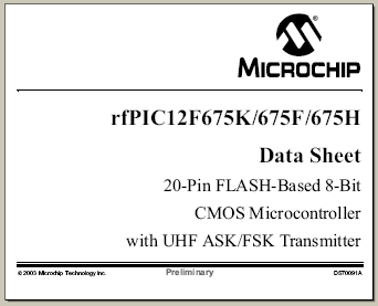

I guess there is one inside my car's keyless entry remote. The pic even has the transmitter buit-in.

I suppose it depends if it's PIC based or not?.
Most of the ones I've seen have a seperate processor along with a tiny transmitter module in a little metal can (usually a round can).
