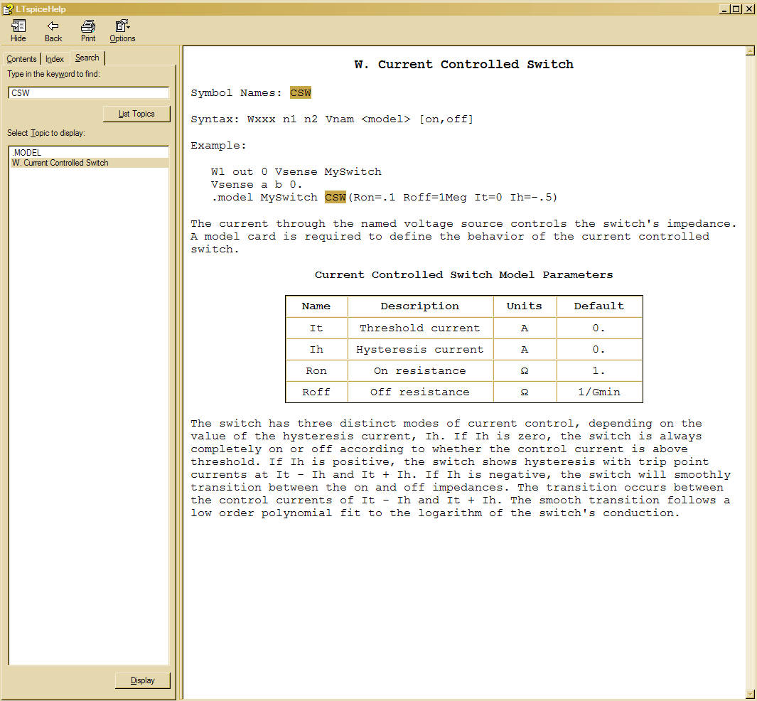

I swear i used the help i read the manual i searched in the internet i did what is written exactly but it doesn't work ? Al this time what should i do ?!
I do not understand why you think you need to use the CSW?

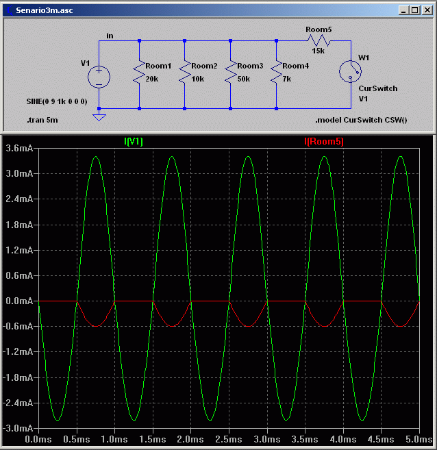

First, as the Help file plainly states: The current through the named voltage source controls the switch's impedance. You did not have the CSW correctly associated with a voltage source.
Not knowing what you think you are doing, using the attribute editor, I associated the CSW with V1. Note that I named that instance of the CSW "CurSwitch". I am using the default behavior of the switch (i.e., it has a resistance of 1Ω when the current through V1 is >0). Now there is current flow through Room5 when the current in V1 is positive...
This behavior could be much more easily accomplish using a diode...
Running example:
  • Senario3m.asc

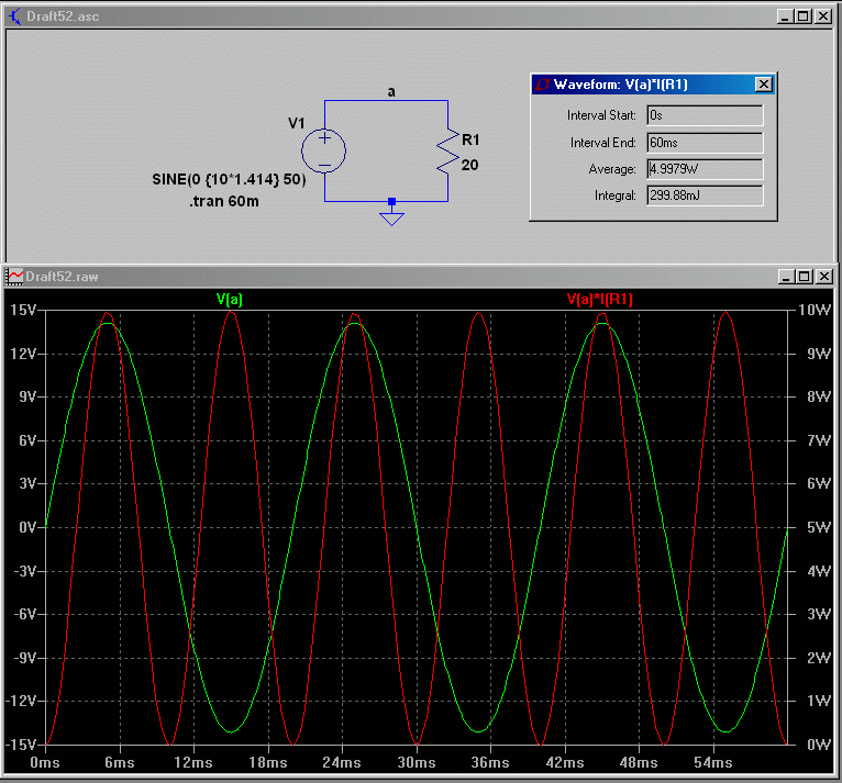

I am sorry but i am wondering you saw my circuit above does the power that the thermometer gives is really the ac power or i have to multiply the result with 0.707in order to get the real ac power ?
If you start with a voltage that is 10Vrms (See V1 in the attached) , and a resistor of 20Ω, then the power in a resistor is P=(E^2)/R = 100/20 = 5 W. Compare that to what LTSpice shows. Note how I told LTSpice that I wanted a voltage source of 10Vrms (not Vpp, as is the default).
If you started with a 20Vpp source, what would you expect the power to be?
But my voltage is ac i didnot have to give it any value but in your example it is DC

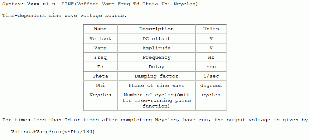

In my example, V1 is a 50Hz Sine wave with an amplitude of 28.28V peak-to-peak (10Vrms) with a dc offset of zero.
Soma, can you not read the Help file? Here is what it says:
