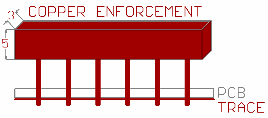

well with the currents involved it is an important matter and most other matters are resolved, I will take your suggetion and use copper wire soldered on to increase current capacity, the working environment could also be "warm"
Know the place of the technology you use... Commonly high current parts of approximately 10amps, don't generally use PCB traces...
One point to mention about soldering tin enforced traces:
They are against VDE and CE regulations and marketing items with that technique is prohibited in Europe (and elsewhere in the world).
The reason is: Hot (>183 or 205deg/C) soldering tin melts and floods the enclosure of the device causing hazardous or dangerous malfunctions.
I recently designed a power supply for 13.8V/40A. The traces are 39mm wide on 70µm copper PCB material.
Some 40 years ago I opened a Siemens high current power supply. All high current traces were enforced with rails resembling a cattle fence. There were "poles" every 10mm carring a 5X3mm copper bar mounted on the component side at 5mm distance from the board surface.
These "fences" would be the best solution I guess, but I haven't seen them since.
Boncuk
Good stuff, it's just square copper bar stock with spot welded .1" posts, in that kind of situation, seriously just use wire =O
