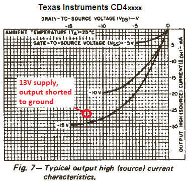

Graphs of CD4xxx Cmos logic ICs from Texas Instruments show "typical" output currents. With a 13V supply and the output is high but is shorted to ground, the typical current is 26mA which produces heating of 13V x 26mA= 338mW and it could be more. The maximum allowed heating of one output is listed on the datasheet as only 100mW so this IC is probably destroyed.

I am talking about destroying a Cmos output that has a datasheet that says its maximum allowed output heating for one output is 100mW.
Lookup the maximum allowed heating for the output of an old TTL IC yourself. I think it gets the hottest when its output is trying to go low but something shorts it to the +5V supply.
it will exceed the maximum allowed on the output and damage the output and the input of the next IC chip?
Why are you talking about damaging an input? It is the output that produces a high amount of heating when it is high and something shorts it to ground.

They do not want. Instead the available current can quickly charge the capacitance of the pcb and the capacitance of the input it is driving.
The available current is higher when the supply voltage is higher because that is how Mosfets work. A higher gate voltage results in a higher output current.
Look at the graph I posted of Cmos output current again. With a 15V supply the shorted to ground output current is 26mA.
Then look at when it has a 5V supply. The shorted to ground output current is only 4mA.
Some manufacturers rate the maximum supply voltage at 22V. Then the shorted to ground output current is very high.
Guess how little is the output current when the supply is 3V.
