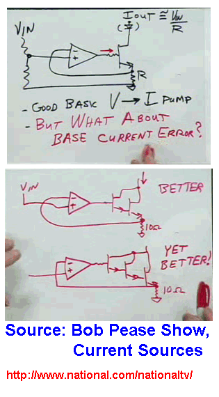

That is a badly designed current source to begin with.
The sensing resistor not only measure load current, but also transistor base drive current too and this will cause big error if load resistance changes.
Looking at what Bob Pease did is to use a trilington(three NPN transistors combination) instead of a single 2N3053 to build an ultra high gain transistor switch and reduce the contribution of Ib to a very very low level. Using even a darlington setup or a MOSFET instead of 2N3053 would be much better in your case.

See image for what I meant by trilington. I can recommend you the book "The Art of Electronics" by Paul Horowitz and Winfield Hill, and perhaps also the following shows what is very interesting to watch.

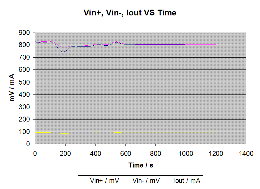

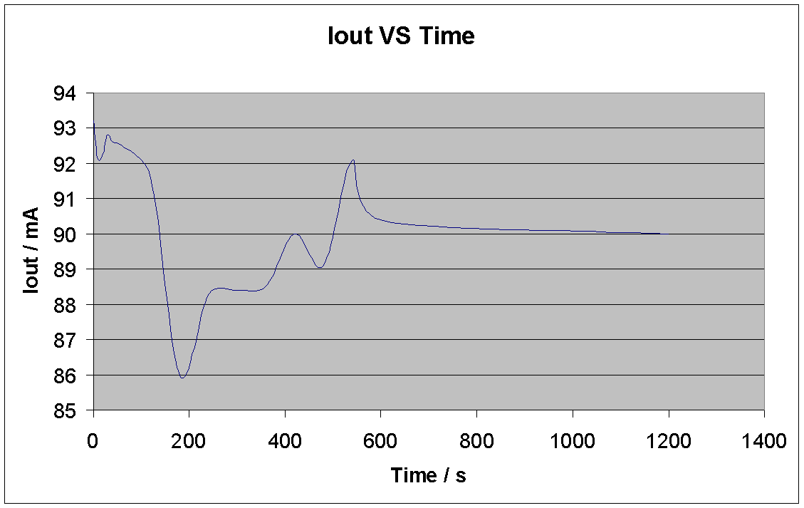

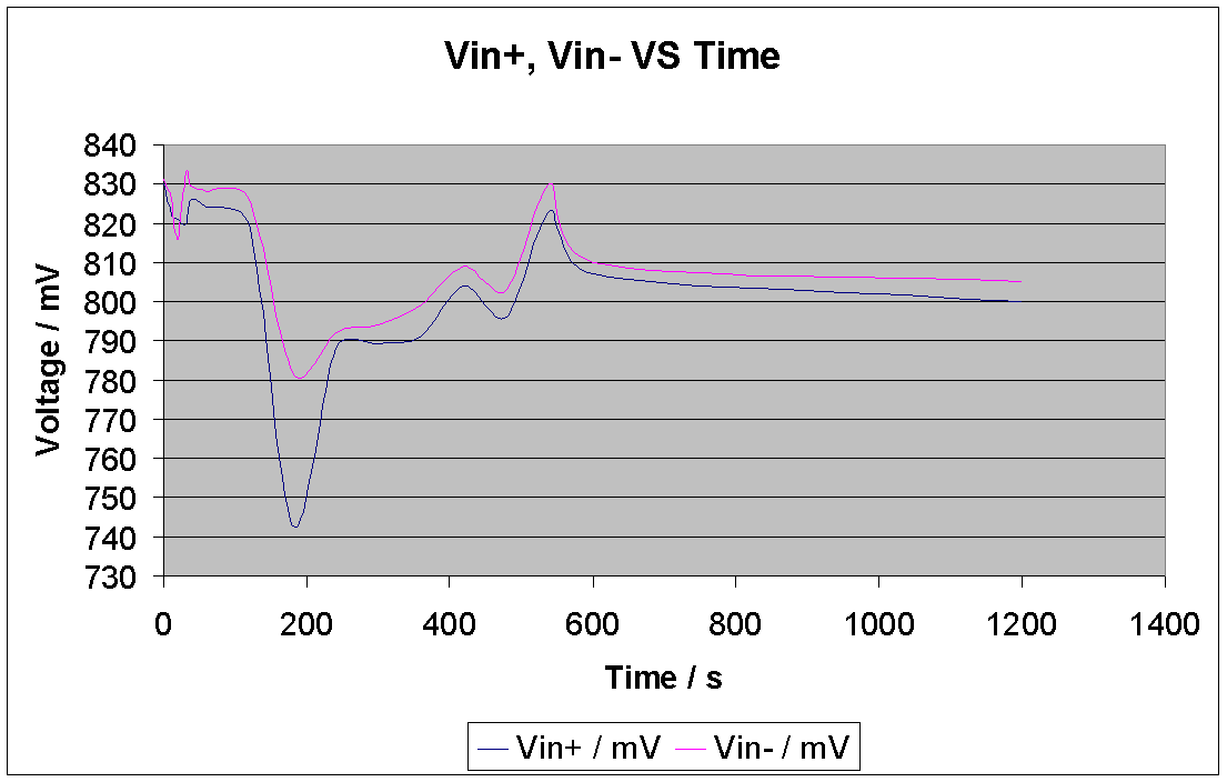

Results...
LC, I completed that test run this morning over a 20 min period. For the first minute I took readings every 10 secs, after 1 min, every minute then after 10 min one final reading at 20 mins. Collated data is attached as a .txt file, use a single-sized font type to view, for example Lucida Console or Courier New.
I punched the data in a spreadsheet and got a few graphs out, quantities, etc all indicated in titles.
Man I really hope this gets somewhere.
  • trblesht_results.txt

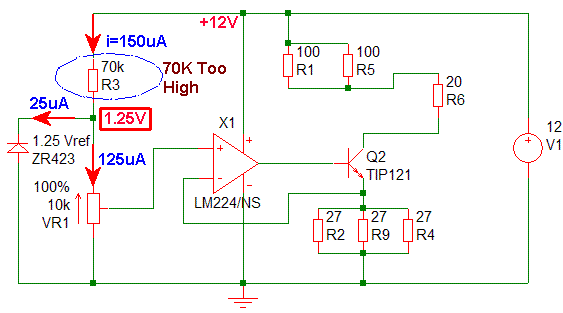

Good work, vicious5id.
From your results, I'm surprised that even the reference voltage changes. The reference voltage determine the load current and it has to be rock solid in order for you to have a constant load current. when reference voltage changes, everything changes.
Looking at the value of the circuit responsible for creating the reference voltage, I have calculated that the resistor value of 70K is definitely too large. The ZR423 can only function properly when current through it is larger than 50uA whereas now it only has 25uA passing through it and it does not function properly.
So you have to increase the current in the ZR423 and I would recommend about 100uA (datasheet min. 50uA or more) to get a stable voltage. I trusted that you can work out the correct resistance by taking the total current through the resistor and the voltage drop across it.
After changing the value of this resistor, hopefully your circuit will work to your satisfaction.
