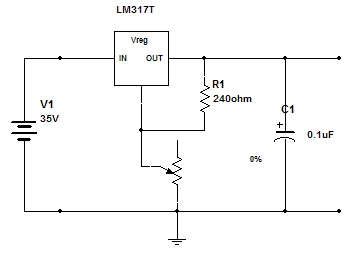

hi all, how do i add a current limit to an already built power supply?
this power supply has current of up too 2A and 30V. i want the current limit to be able to reach 50mA to 2A.... thank's :eek:

It's likely to be far easier to add it internally, rather than externally. Have you built the PSU?, or did you buy it?, and do you have the circuit diagram?.
Any external circuit will require a device to pass the full current, and large heatsinking as well, plus it will drop some voltage and reduce the regulation of the output voltage.

basicly it's a double PSU that uses the LM317T regulator, the schematic below shows one of the LM317's.... the Pot. is 5.5K

Download datasheet for LM317T. There is an example of regulated power supply with current limiting (uses additional 317 for current limiting).
i looked there, but isn't there something simpler? plus i can't find those FET'S anywhere.... and inserting a negative voltage is not an option too... any ideas?

I don't think there's going to be a simple option, the limitations imposed by using a 3 pin regulator IC prevents anything simple.
Assuming you're wanting to build a nice versatile lab PSU, I would suggest dropping the 317 and building something more complicated - perhaps using a 723 IC and external transistors, there are loads of designs about.
