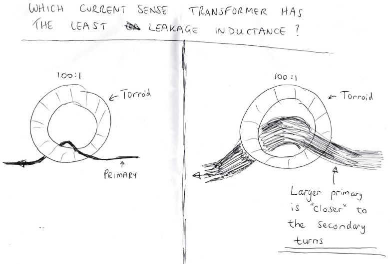

Please advise which of the attached diagrams has less leakage inductance, as seen from the primary of the current sense transformer? Its for a 45khz boost pfc stage

both will have lots of leakage.
Dont need to wrap a half turn , just insert wire at right angles and make the wire fit the hole for least leakage and make depth greater than hole size.(DELETE)
I forgot this was 45kHz.
Use the W material (10k) and shoot for 200~250 mH with 100:1 ratio of AWG30
The lowest frequency the CT can see is related to you inductance and resistance on the 100 turns.
The highest frequency the CT can see is related to the self resonances of the 100 turns. So keep the wire to wire capacitance low.

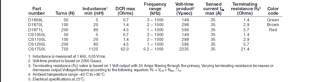

Take the D1870L for example. 100:1 turns. 20mH 2khz to 1mhz. I think the self resonant frequency is about 10mhz. I could go check.
You need to test to see if the 298VuS is OK.
As for the 35A rating. That is at 2000 Gauss. If you change the 2.9 ohm Rt to 1.5 (1/2) you will reduce the VT by 2:1. I know the coil will work fine with the Rt=1.5 ohms. I don't know if it will work at 70A but I know it will work fine at 40A. You will have some errors because the CT was designed to work with 1.4 ohms of wire (internal) and 2.9 ohms external. If you reduce the Rt the 1.4 ohms becomes a bigger part of the equation.
Bottom line reduce Rt. I have used Rt/10 and Rt*10 and they work. In your case I would reduce Rt to 2 to 1.5 ohms. Use the "off the shelf" part. Don't make one.

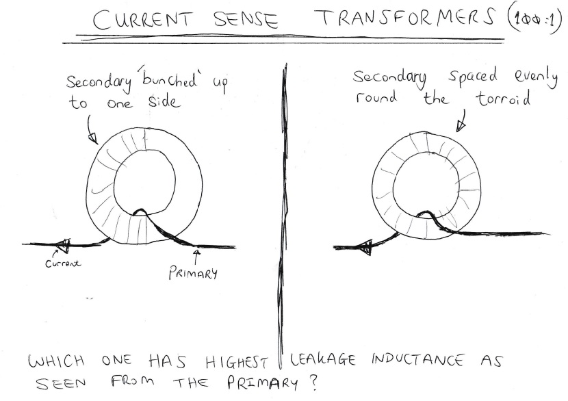

Please advise which of the attached digrams of current sense transformers do you think has the least leakage inductance as seen from the primary?
