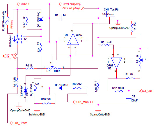

Please I need some advice on this analogue circuit.
The circuit attached is used for sensing current flowing through R9 (1.2Ohm). CH1P_H and CH1P_L are a pair of probes in a specimen which will conduct current and I need to measure it with 1mA resolution. CH1_return and all grounds are shorted to a common ground point. CH1_MOSFET will on the channel via MOSFET Q1. I need a resolution of 1mA. So for each mA flowing through R9 will create x mA*1.2 mV. R6, R7 and R11 forms a voltage divider and will deliver mV to the opamp. Preset R7 is adjusted such that out of the 1.2mV created for every mA through R9, only 1mV reaches the opamp. Then if I measure the output of the buffer U1 it will give the current directly in mA. (If U1 output is 10mV then current through R9 should be 10mA.) CH1_TestPb is the test point to measure this voltage. U2 will amplify this out of U1 (0-500mV)to (0-4.882V).The out put of U2 goes to a PIC with 10 bit ADC and 5V reference. The result when divided by 2 will give current in mA. This is the plan. MCU part is OK. But the signal conditioning section, ie this opamp part seems not perfect. I am not very expert in Analogue circuits.
First of all within your time constraints please advice about any serious wrong design practices in this part.
The main problem I am facing now is the inconsistency in the settings of R7. When I load some 20mA through R9 and adjust R7 to give 20mV at opamp out test point, All is well. Then when I load 200mA the Preset R7 needs re adjustement to get 200mA. So my entire plan fall apart.
Please give suggestions to solve the issue.
Roy
If I am following your circuit correctly, Q1 CC source is been split into two paths.
One via R9 thru the 'test piece' and the other via R6/R7 and R11, this give a non linear voltage drop across the R7 slider take off point and the voltage follower OP07.
I would suggest you relocate the R7 trim pot , so that it not part of the test signal.

Please re-post the circuit as shown in your original post, showing the external connections pathways.
Your circuit relies on OpAmpQuiteGND being exactly the same voltage as Ch1_return. It is extremely difficult to ensure that, because of all the currents flowing there.
Can you use a much larger sensing resistor? If you used a 10 ohm resistor, you could just connect the voltage from that straight to the ADC, with no op-amps. Do you need to measure currents up to 0.5 A? If not, you can increase the sensing resistor more, and scale the result in the software. Either way, the larger the sensing resistor, the larger the initial voltage and the less effect small voltages have.
If you have to use a small sensing resistor, you need a differential amplifier circuit that does not rely on the lower end of the sensing resistor being at a particular voltage. Something like https://en.wikipedia.org/wiki/File:Op-Amp_Differential_Amplifier.svg where Rf = Rg and R1 = R2. You can also use the same circuit to amplify, if Rf > R1. You do need to match Rf and Rg, as well as R1 and R2 accurately, so you need precision resistors for that.

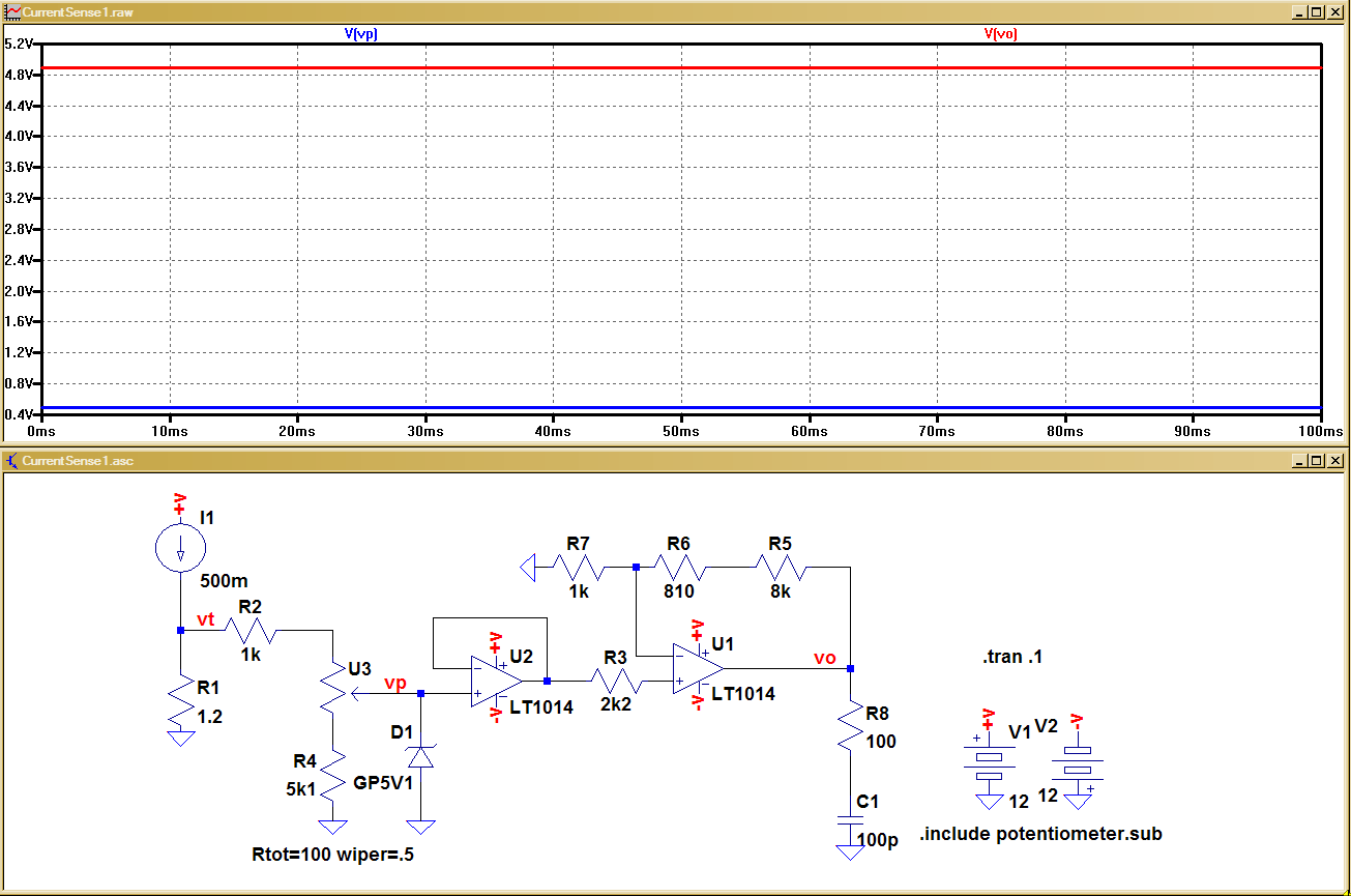

This is the bare bones of your circuit, can you confirm its correct, then I will try some sims.
Thanks. Some slight changes there.R5 is 8.2k and R6 is a trim pot of 1k
Also output is taken from the junction of C1 and R8.
I am using OP07 as the op-amp with +9 and -9 as rails. I tried in Proteus - seems OK
But in hardware gain low in the lower voltage ranges.

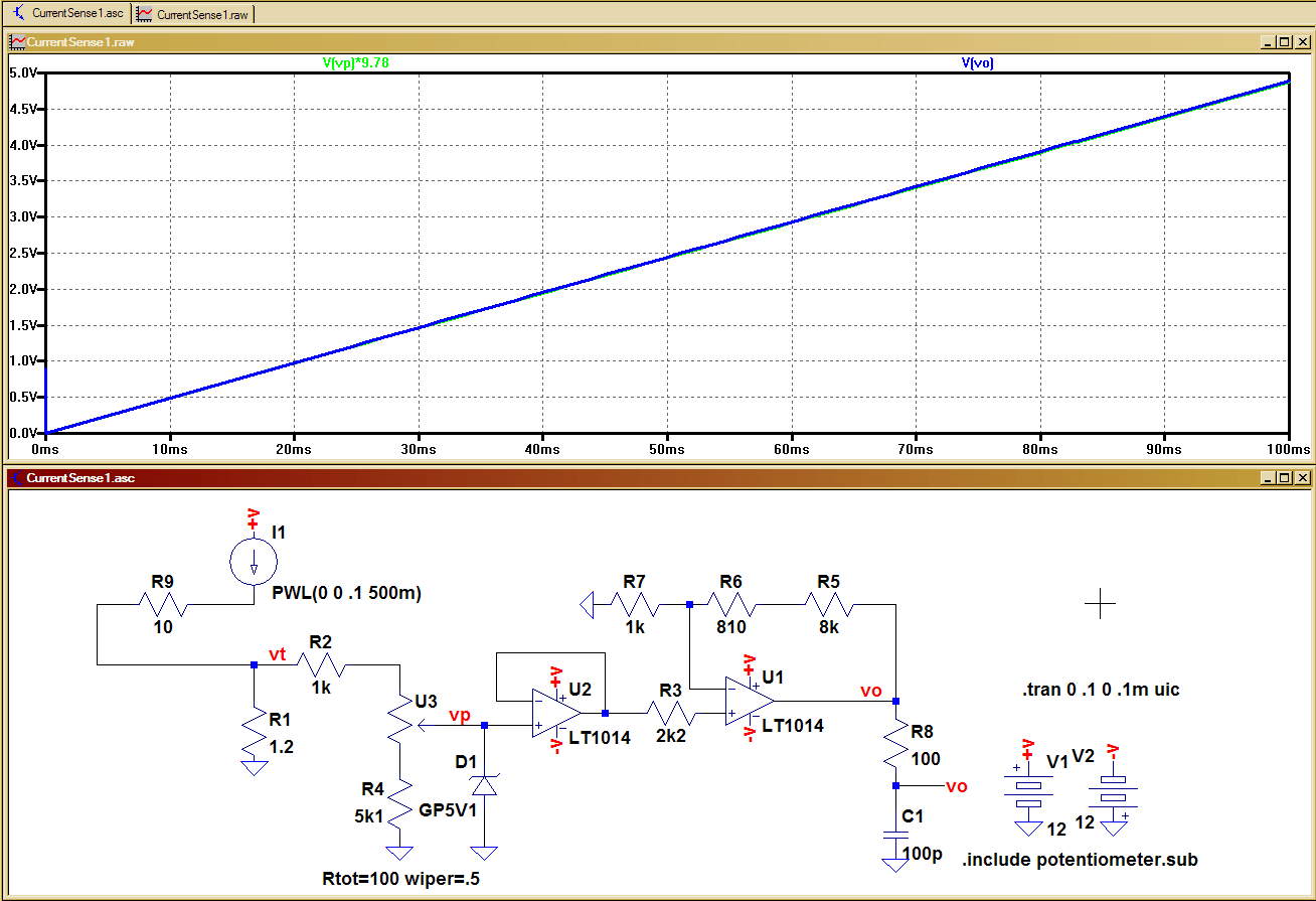

hi
The R5 and R6 are set to give a gain of 9.78
This sim shows a current sweep of 0m to 500mA.
The Vo is plotted together with Vp*9.78 and the plots overlay perfectly.
Its possible that the non linearity problem is somewhere in your 'layout' rather than the circuit.??

Thanks for the help.
That means neither circuit nor opamp is having a non-linearity issue.

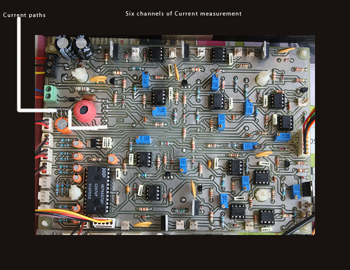

I would check for ground paths that the test current is sharing with the OPA's
EDIT:
If you could post some clear pictures of your pcb, I maybe able to suggest changes
Here it is. It is six channels of current measurement.

One more point regarding the shift between 20mA and 200mA.
The 1R2 current sense resistor, whats its power rating and temperature coefficient.?
I dont know how long a period the 200mA is enabled, but have you taken into consideration self heating of the 1R2.???

The current sense is not any special Shunt resistor for that particular purpose.
I have used 5W fusible resistor mounted on the bottom side of the PCB.
Yes, I understand the drift that can be induced due to heating. But that can be tolerated in the application.(At least as for now!). But this change I am experiencing is present even if we test for a few seconds.
