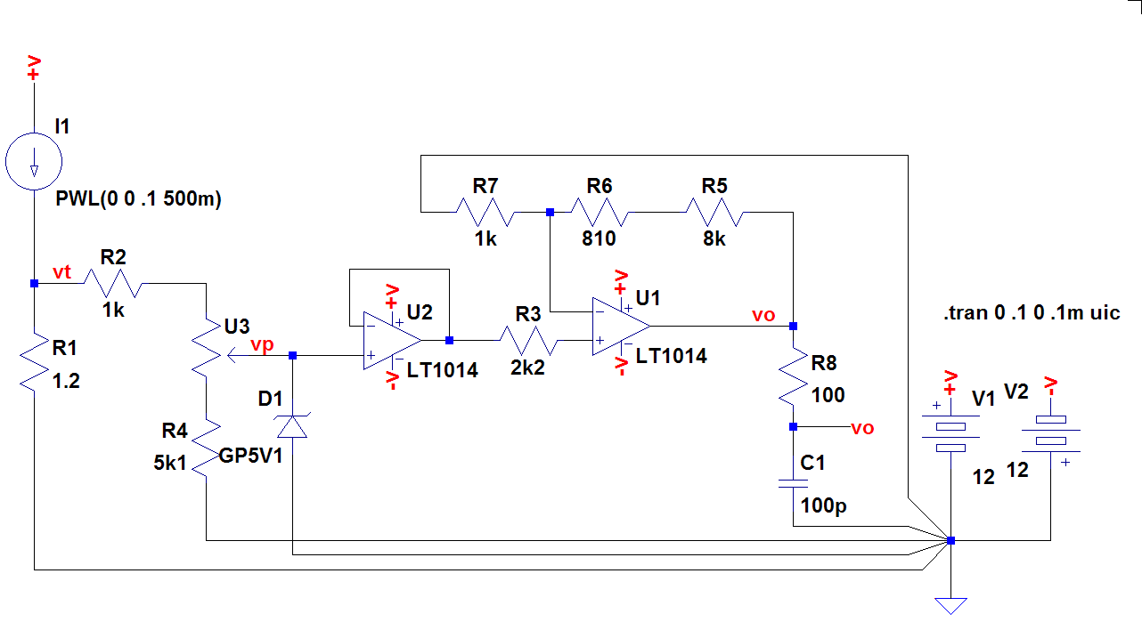

Are you saying that the 'drift/offset' increases with time on the higher current test results.?? or is it present from 'cold' at first power ON.?
Looking at you image of the PCB, I would say its going to be very difficult to make any changes to the current return paths on the pcb.
Have you checked that the CC source is providing a constant 200mA thru the 1.2R resistor also
have you measured the 'offset' directly across the 1.2R, using a calibrated multimeter.??
Yes.it is present from 'cold' power ON!
PCB can be re-designed. But if each ground path is to be routed as shown in your schematic, I think considering the number of channels, it will be better to go for differential amplifier. What about that?
When I maintain a 200mA continuous load ,it slowly changes. This application can tolerate such drifts because the test results has wide acceptable ranges. But showing a different value even at switch on at low currents during demonstration is a bad idea!
After the first phase is over I may modify this with precision shunt resistors.
I cannot say that I am using a high quality calibrated multimeter, but reasonably accurate. But I can see comparative differences in readings anyway. In the extreme low current ranges the op-amp output seems slightly attenuated comparing to high voltage levels.
