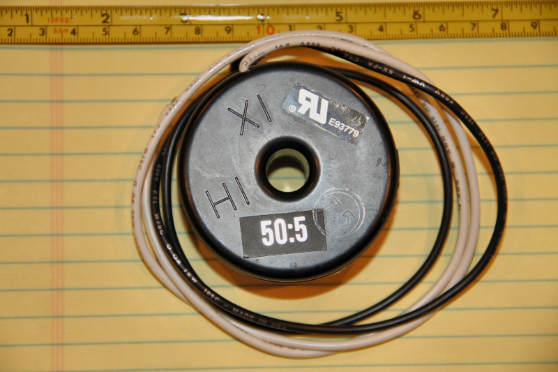

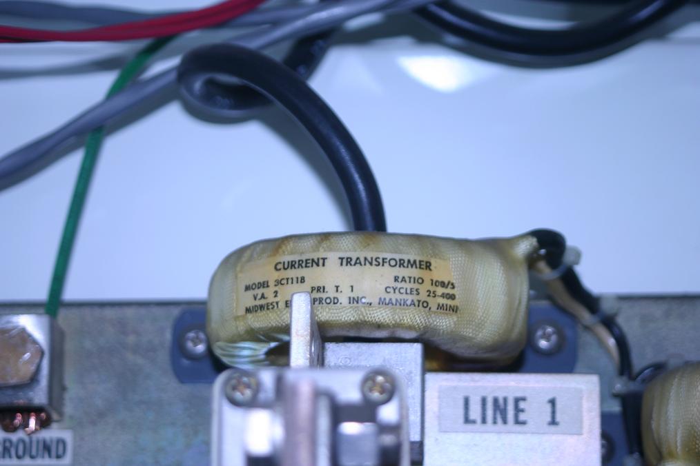

No there is no Primary in a sense of a winding. The primary is a steel core with a secondary winding wrapped around it. Thus my refrence to donut as CTs of the type I suspect the poster is ordering are frequently called donuts. I attach a few images. The 50:5 I believe the OP is ordering is one I had lying around. The 100:5 image is of one at work monitoring a 3 phase 480 volt panel for some heaters.
Using a 500 Ohm load will result in accuracy problems. The problem with this Chinese stuff is they actually don't mention burden in the data provided. The burden can be and is usually specified in VA. It can be specified in resistance but I have never seen a rating of 100 Ohms. That is exceptionally high for a CT, even a 50:5 CT. They don't exactly say that 100 Ohm number is burden.
Voltage or voltage breakdown have nothing to do with it. When the main current carrying conductor passing through the CT (donut) is carrying 50 amps the CT will output 5 amps into a load. That load needs to be a very low resistance (burden) for the 50:5 ratio to be maintained. When using a CT even the lead length (resistance) is critical. The 50:5 ratio depends very much on burden. Note the 10 Ohm load in the chart.
