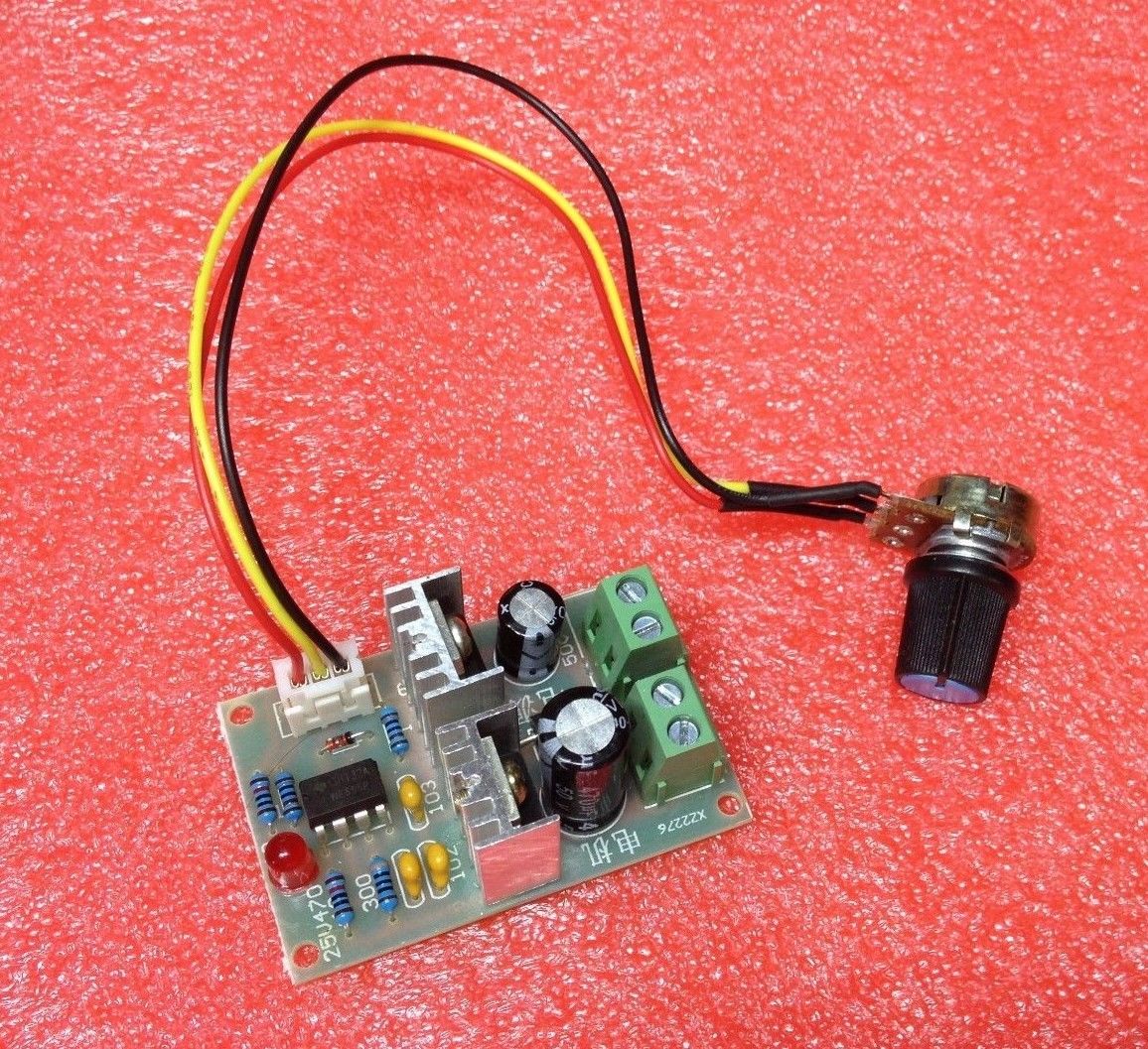

Currently I have 10 fans inside my gaming pc. 2 are OEM fans that plug directly into the motherboard into separate 4pin (PWM) fan headers. The other 8 fans I have added myself. To power the extra fans I purchased a PWM motor controller (picture 1), and wired the input terminals to an extra power connector coming from the PSU (12v). This setup has been working great for months. Based on CPU temp the computer controls (the 2 fans) fan speed via PWM. So, for the other 8 fans, instead of having to turn a knob (POT wired to controller) I would prefer to somehow tap into the OEM PWM circuit (to allow the computer to control all fans based on CPU temp). I understand that I cannot simply tap into the OEM fan wires, due to the amount of current being drawn by the other 8 fans will overload the circuit. So is there a circuit/module similar to the one I purchased that uses an input wire to reference and existing PWM signal instead of a POT? Basically to copy the PWM but using power being supplied directly from the PSU.

I believe that nearly all computer motherboards I know of have a separate PWM pin for controlling the fan speed. That 555 controller from your image looks like it would just PWM the power to the fan, which is doable, but not ideal.

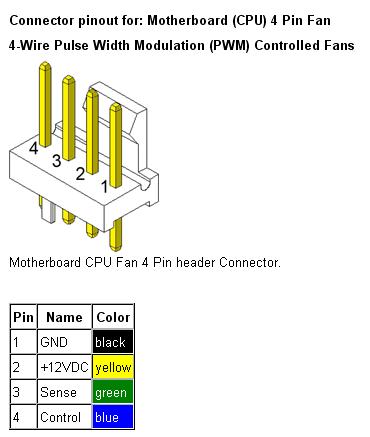

First, you need to figure out what kind of fans you have:
Fans with 3 pin connectors will typically have GND, +12V power, and a fan speed sensor. Rather than controlling the fan's speed, this just reads the number of pulses from the rotation inside the fan's motor (usually using a Hall effect sensor, I believe), which can then be read by a software program or through the BIOS.
Ideally, you will want fans with 4 pin connectors: GND, +12V, speed sensor, and PWM control.
From there you can just graft the PWM inputs of the other 8 fans onto the PWM control pin of the CPU fan. As Spec mentioned, the input impedance of each of the fans is probably quite high (such as that of a CMOS input gate), so connecting several in parallel probably won't be an issue. I don't recommend connecting all the fans to the same power pins, though, as that would be quite a lot of current for a single Molex-type pin to handle, especially in such a mission-critical location as your CPU fan.
If all your fans are 3-pin or even 2-pin (just power and GND), then you are going to need to get a bit more technical and connect a buffer in series with the PWM output from your MOBO and use the PWM signal to switch the power rails of your fans. A high side driver ship, or a level shifter to a power MOSFET would probably do the trick. You may need to add in a back-EMF diode to protect against the voltage spikes from switching the fan motors on and off-- I'm not sure if those come standard in computer fans or not.

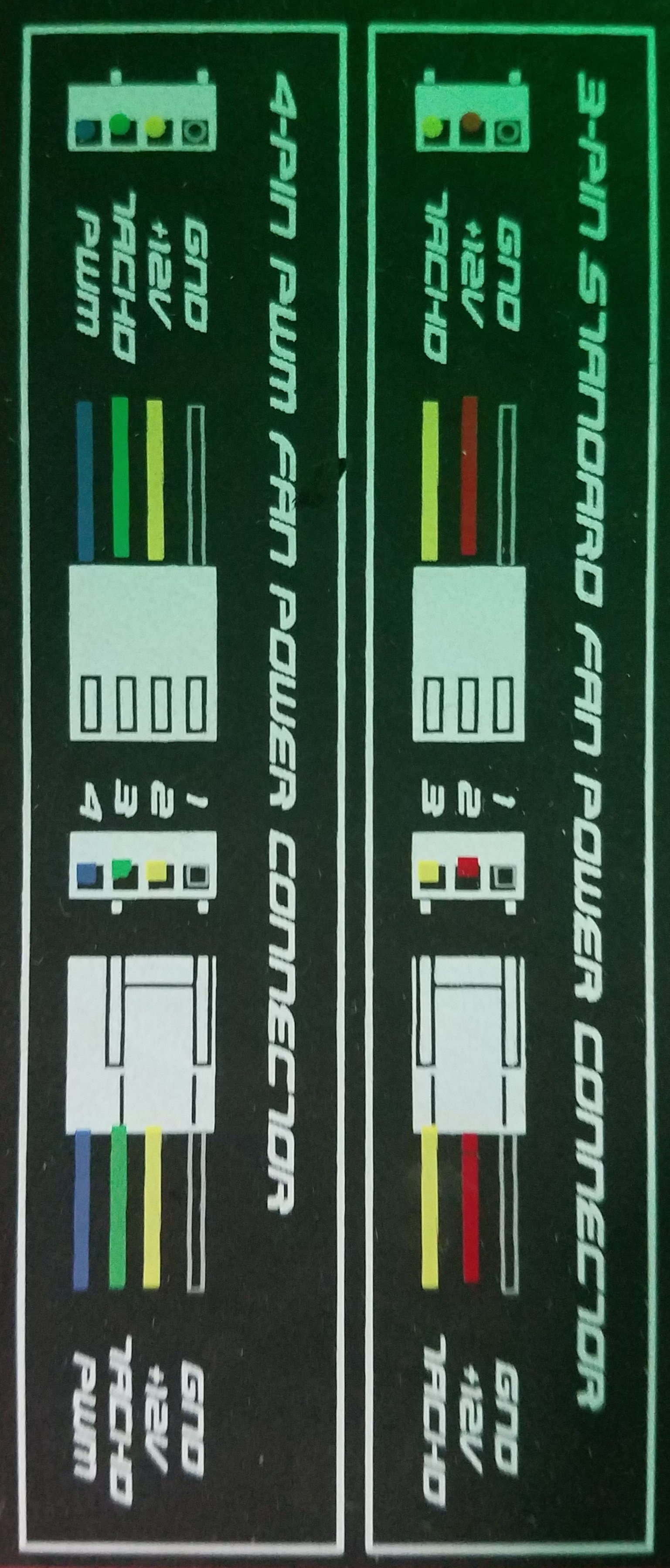

Most PCs have two different styles of fan connectors (fan headers); 3 pin (-, +, and tach out) (runs fans at constant 12v no PWM) (no PWM controller built into fan), and the other style 4 pin (-, +, tach out, pwm) (PWM controller built into fan). I understand what you're saying, i didn't think of that, but the 8 fans I have added are 3 pin as appose to the two OEM 4 pin fans that vary speed based on CPU temp. So because the 3 pin fans are able to be PWM controlled, but the computer itself does not pwm them, I assume that the extra pin/wire in the 4pin is to send a reference/signal to the integral circuit board inside the fan itself to pwm the fan motor. So is there a controller that can do what the 2 fans do, take the blue wire signal from computer and create a pwm signal output (to fans) ?

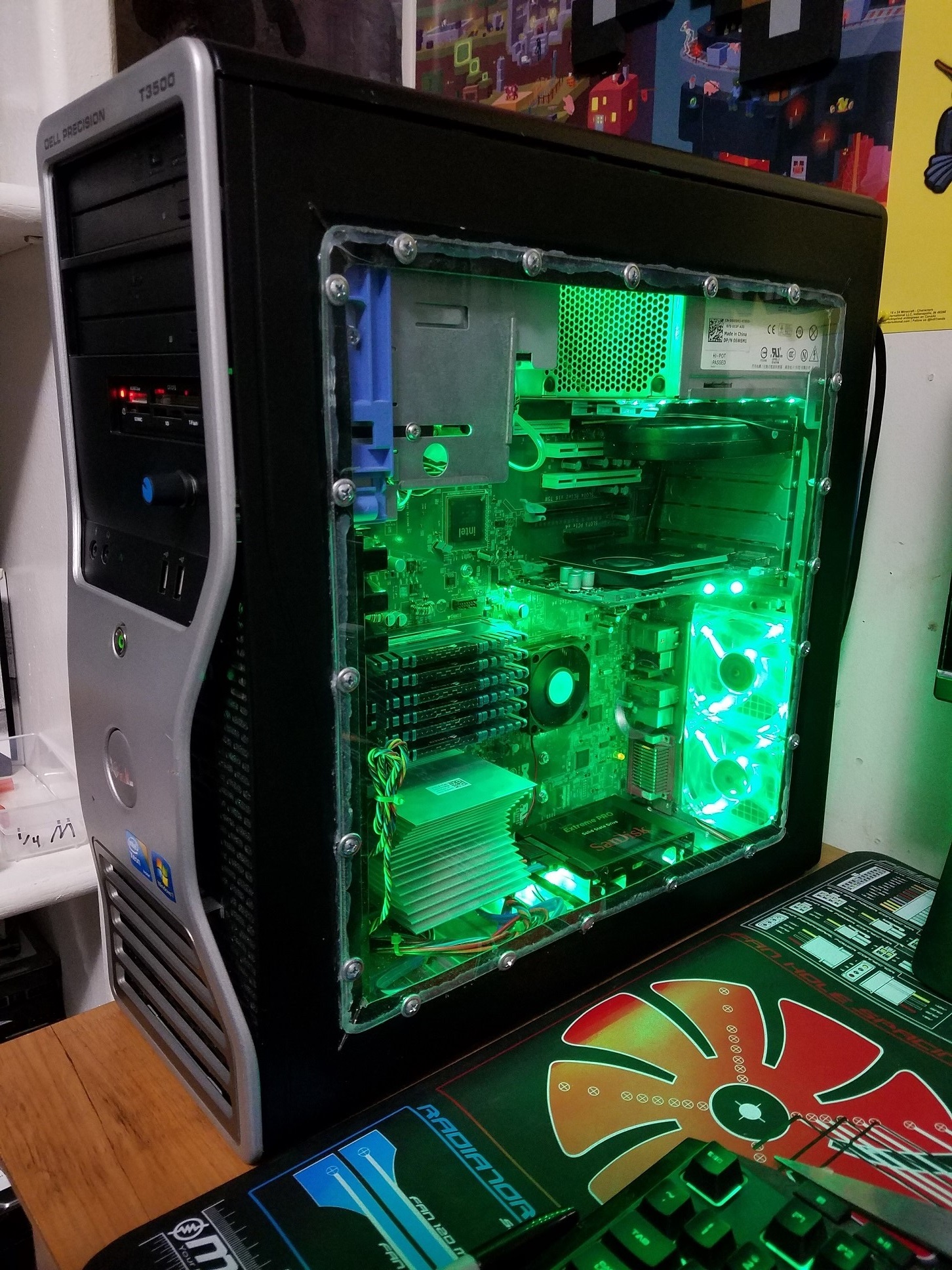

Oh and I know the picture wont help with any technical info, but here is my computer (the LED strips run on same parallel circuit as fans)

Snazzy looking rig you got there. Gotta love Dells and their crazy left-hand mounted motherboards, but where are the fans going to go?
Yes soldiering things are fine. You would recommend building it as appose to buying a prebuilt?
Yeah I love the left side mobo mount design. The fans are already in (PSU, case exhaust, pci exhaust, northbridge, ssd, etc.). I've been running the 8 fans using the PWM controller I purchased for a few months now, just decided that I want the computer to vary fan speed, not me.

It's still not clear if your 8 "other" fans are 3 or 4 pin fans. If 4 pin then it's simply a matter of running the motherboard pwm signal to them along with power.
Mike, the other 8 are 3 pin. So they don't have the ability of self-PWM, they need either ground or power to be pwm by a controller. The issue is finding a controller that has signal input (most have POT) So the controller itself can mimic/mirror/copy the pwm going to the 2 OEM fans, while operating on a separate power lead. I will most likely be building it from parts such as the ones JLNY suggested. Any suggestions?

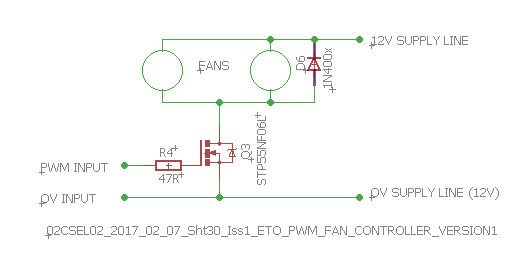

Hi Cole,
Right got your position.
So, in summary, you would like to route the PWM logic level signal from the computer and drive a separate power driver that pulse width modulates the 12V to the auxiliary fans.
This can be simply implemented by one low gate threshold power NMOSFET transistor, one 1N400x diode, and one resistor, as shown below.
spec
I thought Cole already had a PWM driver board that he was using to control all 8 fans, and that setup was presumably working. Is there any reason he can't just use the PWM signal from the motherboard to control the driver board he already has? It could feed into pin 4 of the NE555, and the timing capacitor could be shorted to make the NE555 act as a buffer. This is assuming that the output stage of that board is an emitter-follower configuration; it not, then a transistor inverter can be used.
Yes, good points- why didn't I think of that.:)
But you may find that using a power NMOSFET is simpler in the end.
spec
spec
Yes, a single FET that operates at logic levels, and maybe a free-wheeling diode is also pretty darn simple. PWM frequency is apparently around 25 kHz.
HI D83,
I have now posted the schematic in post #17 showing a circuit along the lines we discussed.
spec
If you smoothe the PWM with a simple RC filter you get a voltage. Won't the POT type controller accept that as equivalent to the pot wiper voltage?
