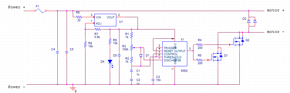

Okay, so I think I've reverse engineered that board (I'll still need to check my work, because it's kinda tricky with all the boards in the images at Dutch angles hehe). I can't read the part numbers off the TO-220 package parts to be sure, but I'm pretty sure it is using a 555 astable to drive two N-channel MOSFETS in parallel as a low side driver. It has what looks to be a TO-220 package double-diode (probably Schottky) in parallel as a back-EMF diode. I'll draw up the schematic when I get home later today, but basically I think it could be as simple as unsoldering the 555 chip and connecting the PWM signal where pin 3 used to be...
Okay, so here is the schematic I came up with from those photos. It's hard to tell in a few places, and I'm making some educated guesses on what the TO-220 package items are, so you'll probably want to double-check my work on the real board.
Basically, it is a 555 astable to a low side driver, which works perfectly for modifying it to run from the PWM signal from the CPU fan. If those MOSFETs are able to be driven to a reasonable current from a logic level signal (you'll need to check the part number on the various TO-220 parts and look up the datasheets, or just post the numbers here), then it should be no issue to just unsolder the 555 timer IC and solder the PWM signal onto the pad for pin 3. If not, then we may have to change out the MOSFETs or rewire the 555 timer in some way to act as a buffer for the PWM signal. Others may be able to advise on that.
The board seems to use some kind of weird voltage regulator configuration for dropping the voltage to the 555 timer. At first I thought it was going to be a fixed regulator, but it seems like it has some resistor support components which suggest it might be a variable regulator like an LM317 or similar. I didn't feel like tracing it out as it isn't really critical to what we need to know. I also left out the indicator LED, which I believe is also run from the voltage regulator.
Here is an updated schematic with the regulator filled in. I'm not 100% sure if I'm reading the values for R8 and R9 correctly. Anyone can feel free to double check and/or correct me on anything here if it looks out of place.
Edit: Cleaned up the layout of a couple junctions.
JLNY, thanks for the hard work on the schematic. To convert the board to a buffer, simply remove the POT (R3) and short out C1/C2, and feed the PWM into pin 4 after separating it from wherever it's currently connected.

LM317T is a variable voltage regulator. However, for the values of 5.6k and 10k that I have listed on my schematic that would only be an output of 3.5V, so I don't think that's right... I've probably misread one of those resistors... if R8 were actually 30k instead of 10k, that would be abou 7.9V out nominal. You could always try to measure the regulator voltage if you wanted to be sure.
I'm not getting anything on the part number 30CT0100, but I'm guessing that it's the double-diode.
R7 should be between 120 and 240 ohms. I would need to check the datasheet, Some people get it wrong. The lower number is usually better. What's the regulator output?
12 V rail, R9 should be closer to 1K. A high efficiency LED could put it at 10K.
Be aware that the voltage threshold of the reset pin of the 555 is very low. So unless the PWM output as seen at pin 4 of the 555 goes right down to zero volts, and there is almost no voltage differential between the two grounds, when fan current is flowing, then this may not work reliably.

That is a good point. The control signal is spec'ed at similar low level of 0.8V max for low level output (http://formfactors.org/developer\specs\4_Wire_PWM_Spec.pdf page 9), which is more than the minimum 0.3V (typical 0.7V) of the reset pin . I would expect it to be very close to 0V though and I expect it will work; if not, then there are some simple things to fix it (namely a series diode and resistor pulldown).
