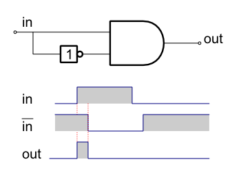

what if the circuit is too simple to have a fn generator to produce the clock .
Then you can use a AND gate and a INVERTER to produce a short spike whenever the voltage from the generator shift from low to high:
