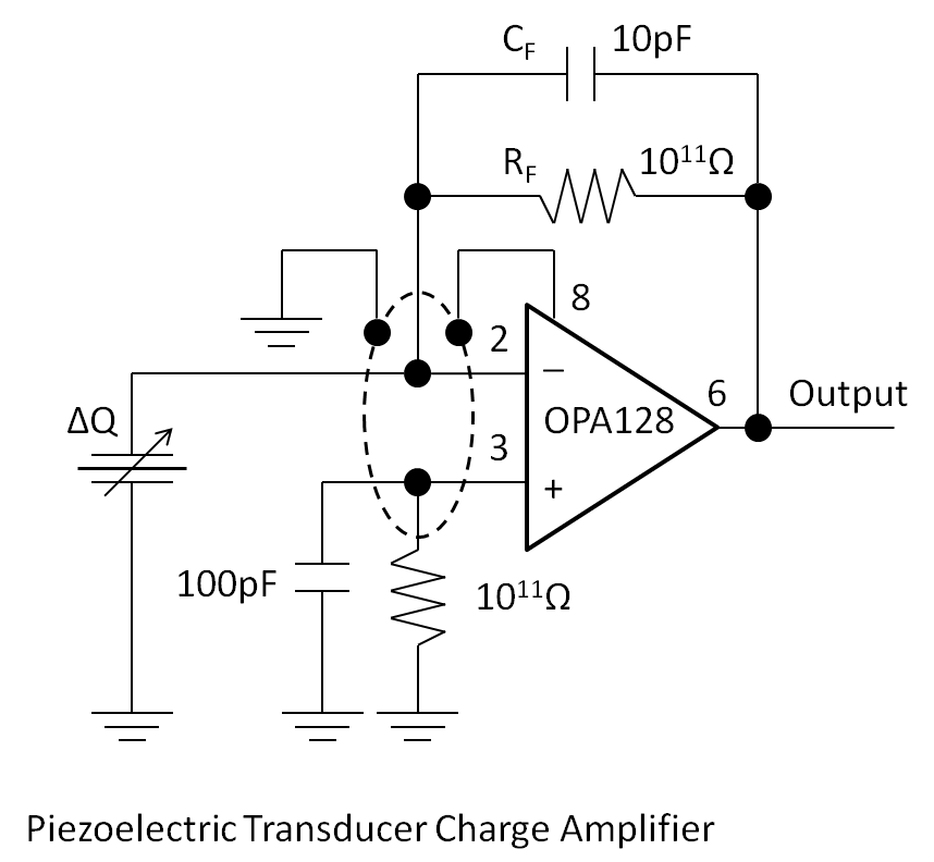

I am trying to build a circuit (schematic attached) and I have no idea how to wire up the part involving the dashed circle. What is this? Is it a part I need to buy? Is it a particular way of wiring? Thanks in advance.

That's a guard. It basically means that the op amp terminals are surrounded by a copper loop similarly as a shield would. Guards are typically driven at the same potential as the input. What it does is to reduce dramacically the leakage paths. If a high Z input is surrounded by the potential of the input, then there will not be leakage paths between the conductors.
With such high value resistors, you have to consider all leakage paths. Fingerprints are bad. You might also consider teflon standoffs for the components.
See figure #2 in the datasheet. https://www.electro-tech-online.com/custompdfs/2011/03/opa128.pdf
So I would pretty much just wrap the gaurd around the inputs 2 & 3 just like in figure 2? Where do the dots that are directly on top of the dotted circle connect to? input 2 wire?
You don't "Buy" a guard. It's a way of laying out the PC board. See the figure in the datasheet.
Laying out Electrometer amps is very difficult. Been there, done that.
Also, electrometer systems use triax cables. These are about $100 for 3'. The inner conductor is the signal. The inner shield is the guard and the outer shield is ground. Triax connectors come in two lung and 3 lug versions. The 2-lug version can easily be confused with BNC connectors.
Teflon standoff terminals can be purchased at US - Electronic Components Distributor | Newark.com
Dots on a schematic indicate a connection, in this case to ground.
The guard is primarily for PCB mounting of the components. It should be on both sides of all traces that go to pin 2 and 3, on all layers of the PCB. For a trace to pin 2 or 3, for example, it would consist of two additional traces connected to ground, one on each sides of the pin 2 or pin 3 trace.
All guards are connected to the ground connection on the PCB. Think of it as isolation around all the connections to pin 2 and 3. The idea is to drain away any leakage currents from any nearby traces that are at a different voltage from pins 2 and 3.

That's true for a voltage input, but not for a charge input, which this is, and which goes to the virtual ground input of the op amp. In this case you want all the guards connected to signal common.

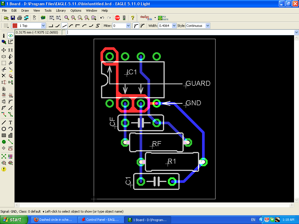

Here is an example of a guard.

OK. So I am going to use teflon standoff connections and avoid the gaurd all together. I am also going to use a polystyrene or teflon 10pF and 100pF capacitor. I have found a 100 pF polystyrene cap, but I can not find anyone who manufactures a 10pF teflon or polystyrene cap... Who makes these???
