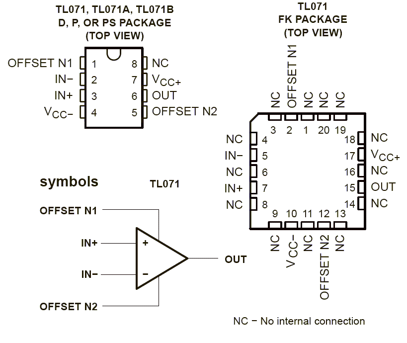

M msbansal New Member Apr 23, 2007 #1 Can anyone provide a datasheet with pin layout for a TL071 CP ic? Thanks in advance. MBA
Papabravo Well-Known Member Most Helpful Member Apr 23, 2007 #2 They should be available from the TI website: www.ti.com
hotwaterwizard Active Member Apr 23, 2007 #3 Here you go. Hope this helps. Attachments TL071_Pinout.gif 23 KB · Views: 3,670 TL071 TL072 TL074.pdf TL071 TL072 TL074.pdf 823.8 KB · Views: 698 Last edited: Apr 23, 2007

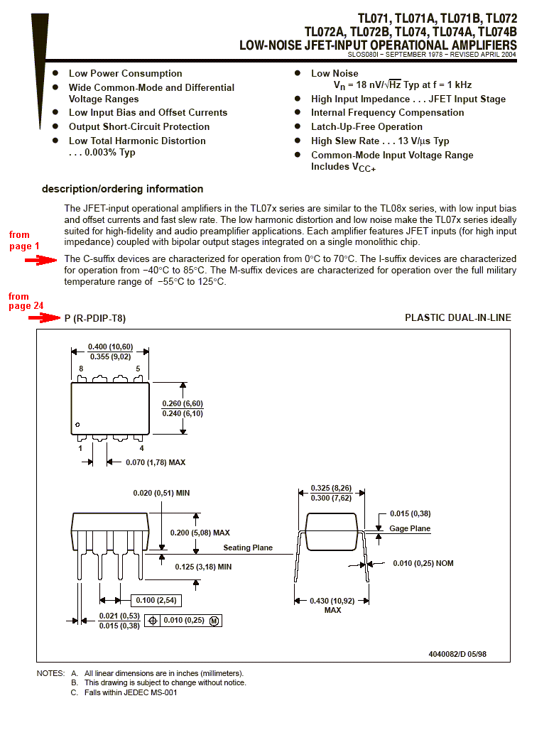

M msbansal New Member Apr 24, 2007 #4 Thank you very much, but can anyone explain what (TL071 CP) the letters CP signify as I have been looking for an exact match for datasheets. Thanks again. Manjit
hotwaterwizard Active Member Apr 25, 2007 #5 In the Datasheet Page 1 Describes suffix C = Temperature range 0 to 70 Deg C Page 24 Describes the P Suffix is Package Type and Deminsions https://www.electro-tech-online.com/attachments/tl071-tl072-tl074-pdf.12593/ Attachments page 1 and 24 combined.gif 43 KB · Views: 626 Last edited: Apr 25, 2007
