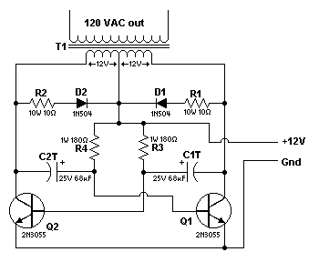

I have been trying to build a 12VDC to 120VAC voltage inverter for some time now, and came up with this design a while back. I have tried building it several times, but All that happens is the wirewound resistors start putting out extreme amounts of heat, and no voltage output. The attached image contains the schematic.
Also, I have tried reversing the polarity of diodes D1 and D2, removing them completely, and using several different types. Still nothing.
Is it possible that some parts are defective, or is there a flaw with the design? I'm open to suggestions and modifications to my design.
Note: C1T and C2T are tantalum electrolytics, R1 and R2 are ceramic-cased wirewound resistors.

Hi JBlatt,
Hmm ...
You have the caps backwards.
And why have you got diodes across transformer windings?
I think you should remove the diodes, and their resistors.
Check the remaining components are ok,
And you may find that the 12v windings are a far lower
impedance than you realise.
They should take up around half of the window space to
act as a primary winding.
And since you are using them half at a time,
maybe they should take up a bit more than half.
Those considerations wouldn't stop it working,
but would badly affect its efficiency.
Also, check that your two windings are connected as you
think they are,
if one is reversed, you would get no output,
You may have a pair of wires for each 12v winding,
The two ends you join to make the middle connection
have to be the right ones.
Difficult to say from here.
Best of luck with it, John :)
the 68 mfd caps look a bit large to me ?
and the 180 ohms seem very low to me ?
I would choose a base resistor which gave me between
a volt and one half a volt on its winding, without the
caps in place, that is most of the supply voltage
across the 2N3055, and just a small voltage across its
associated winding.
And the same for the other 2N30055 and its winding also.
At a guess, maybe you have chosen the 180 ohm resistors
in the style of 'Class A output'
In a switching circuit like this, that is not necessary.
Maybe others would care to say how they would set up
the biasing ?
Regards, John :)
Actually, I did not design this circuit, "came up with" was a bad choice of words. I actually found this cirtuit on the internet quite a while ago, and this was how it was set up-- diodes included, and the caps in that direction. I'll try breadboarding a modified one tomorrow with the caps hooked up the other way around, and the diodes/10w resistors gone. Thanks for the suggestions, will post how it works when I get the chance.
I beg to differ, but I think the capacitors are the correct way round.
The capacitors are large and the 180 ohm resistors are small to give the 2N3055s sufficient base current (consistent with oscillating at around 60Hz), because their gain is not high and they are driving reasonably large currents. The alternative to this is employing driver transistors, which would complicate the circuit.
I think the diodes and series resistors are designed to snub out back EMF from the transformer primary which could destroy the transistors.
If you have tried reversing the diodes, you may have destroyed them. Check them with a DMM.
Tantalum capacitors are not tolerant of being reversed nor of overvoltage, so check them too - you might find one or both are short circuit. If you replace them, ordinary electrolytics might be better.
In fact, I suggest you check all the components before switching on again - there aren't many, and all are straightforward to test with a cheap DMM.

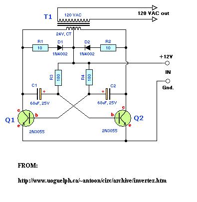

I had a look around on the internet, and i found this:
I will attach the circuit shown from this.
It is not identical, but it is so strikingly similar that
its clear to me this arrangement is a working design.
As Mr Partridge has said, it looks like the caps are correct
as drawn (sorry about that), although it seems there was
some confusion about that from this source too.
Positive to the base, in each case.
The author of this piece also goes on to say that the caps
have to be tantalum, but doesn't really say why, other than
standard electrolytics aren't up to it and may explode or
fail. My guess is that the ripple rating needs to be quite
high.
I still don't really see why diodes are included across the
windings, but there it is.
JBatt,
as your inverter is still not working, i would suggest you
check carefully the direction of each 12v winding.
It seems this circuit is a practical working design, and i
can only think that your windings may not be correctly
direction-ed.
Other than that, theres component failure, or a wiring fault.
There aren't that many parts to check, as Mr Partridge says.

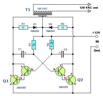

I have seen the same circuit posted on several sites and have built and re-built it exactly to spec. I cannot get the circuit to output <100vac. The first few seconds I plug into the ciggarette lighter, It outputs about 115vac and rapidly diminishes down to about 30vac. The caps and the transistors both get EXTREMELY hot. Whats the problem with this design. :?:
What were you using as a load ?
The output voltage is effected by how much current the load is drawing.
With 12 volts driving a transformer that steps up the voltage to 120 volts, the current will be stepped down by the same proportion.
So, for example, if the current in the "primary" is 1 amp @ 12 volts the current in the "secondary" will be 1/10 of a amp @ 120 volts, and this is considering a 100% efficiency for the transformer.
Also when a load is applied to the output of the transformer the circuit "sees" this as a higher resistance (or impedance) and the voltage/current in the secondary drops off.
Yes the components will get very hot which is why it is suggested that the power transistors be mounted to a heatsink of the proper size and in some cases to add a cooling fan as well.
It appears to me that the circuit is very inefficient and needs some means of regulation.
I dont think the caps should get hot.
I didnt have a load on the AC side besides my voltmeter. I was leary to plug anything into it before i tested for the correct voltage. As far as the caps getting hot, that could possibly be transfering from the transistors. If i use a higher output transistor, will they not run as hot? or by increasing the transistors am i basically also raising their output propotionally? Im assuming so considering what you were saying (nettron) about having no regulation.
Hmmm...that is odd. You said you had it powered from the cigarette lighter in a vehicle, was the motor running at the time ? Im thinking maybe it wasnt getting enough current, but i doubt that.
Perhaps theres an intermitent problem with one of the components when they heat up , i'd suspect the power transistors. Try cooling them down with a fan ( a can of compressed air would be ideal ) and at the same time measure the voltage output of the transformer.
if i use a higher output transistor, will they not run as hot? or by increasing the transistors am i basically also raising their output propotionally?
Yes they may run as hot or prolly even hotter but the heatsink would have to be bigger to compensate for this but i dont think thats the issue. All Power transistors are low gain devices but some have slightly more gain than others. They are primarily power gain devices, meaning they are designed to handle high current loads.
