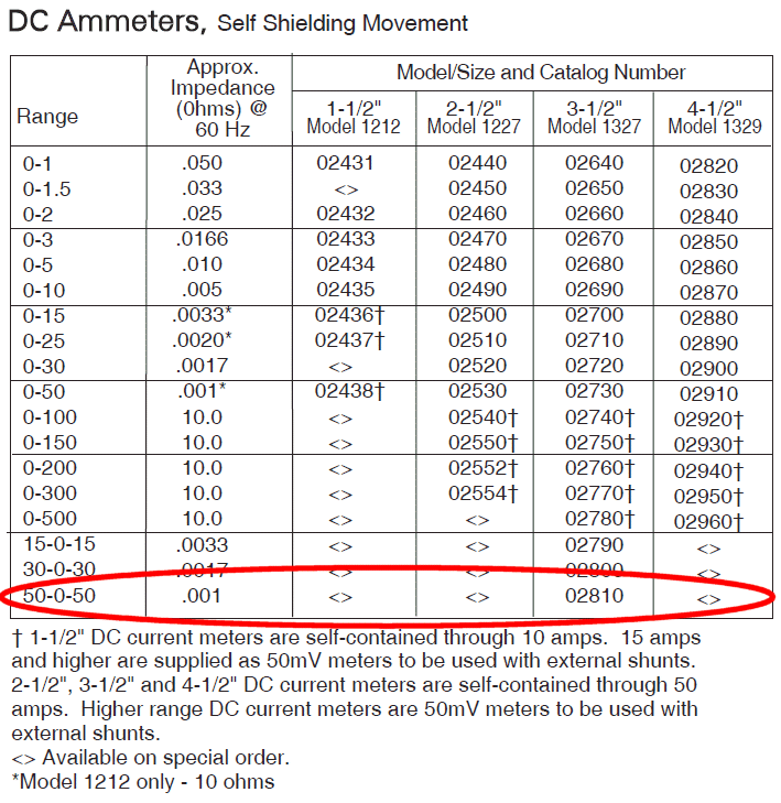

Good day all. I have a DC (50-0-50) analog amp meter. I would like to have it actually read micro amps as opposed to amps. Is this possible and, if so, how can I do it. Thank you.
1 amp = 1,000,000ua. You need an amplifier with a gain of 10^6 that has a 50a output current capacity. A gain of 10^6 is not insurmountable, but the output driver could be. BGmicro has 50ua meters for $10 or so.
The fast answer is NO!. As in no way.
I can not see your meter. There is a chance that the meter movement is actually a 1mA or 100uA meter movement. There might be a heavy piece of wire used as a shunt. Open up the meter and look for a large piece of wire or a flat strap from one terminal to the other. Remove that and the meter will respond with a very small amount of current. How much is a question.

Some of those meters have an internal shunt, and some are to be used with an external, remote shunt. Do you know which type you have?
Shunt is internal
OK, look real hard at the actual meter movement. Look for anything like FS= in small print. Should (with luck) be somewhere on the meter movement face below the scale. Maybe something like FS = 1mA or maybe FS = 50uA? See anything there?

No Sir. All is says on the face is "DC AMPERES" and "Simpson". On a sticker along the side it says SKU:02810 then S/N AH2302551011 then it has the number 1327. That's all I can see. I haven't taken it apart yet because I didn't want to void the warranty.
It's a 3.5" Wide Vue meter, 0.001 ohms resistance. ).001 ohms * 50 amps = 50mv meter range w/o the shunt.
This is the data sheet for the series of meter that you have. Per JaguarJoe, when all is said and done you actually have a 50-0-50 amp meter with an internal shunt and less the shunt you have a -50-0-50mV meter movement. Attached is the meter you have highlighted.
They do make exactly what you want but I don't see it happening with what you have. :(
