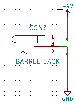

What is pin 3 (see the Sparkfun datasheet link) connected to?

So pin 3 (the center one) is V+, pin 2 is GND, and pin 1 is unconnected
Go look at the linked data sheet again. The center pin is pin 1. The thing that connects the outside of the plug is pin 2, and pin 3 is the switched contact, which is opened when the plug is inserted...
ahaha i guess i got my pinout wrong, but on my circuit it is correct

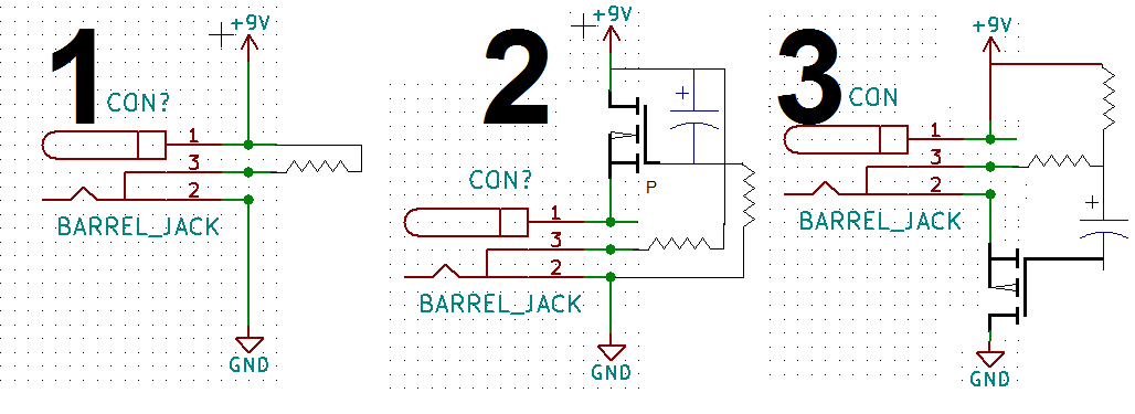

How much, if any, electronics would you be able/prepared to fit at either the plug or socket end. Or maybe a little interface box. If that were acceptable, I think a solution to your problem would be pretty straight forward- a MOSFET and a few passive components should do it, without generating any heat. I'm just thinking out loud at the moment.

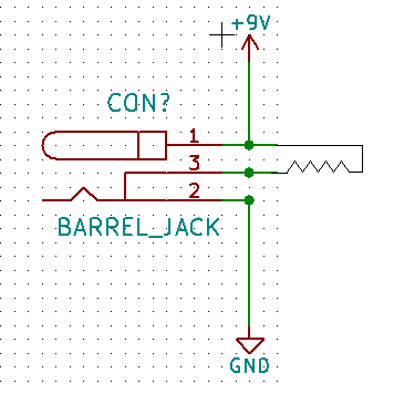

A resistor between terminals 1 & 2 would discharge the cap and when disconnected and drop out of the circuit when plug is inserted.
When you insert the plug, is the power on or off, is the plug power into or power out from the SMPS
2 more cents, If the jack is the power input to the SMPS, #2 & #3 would act as soft starts
