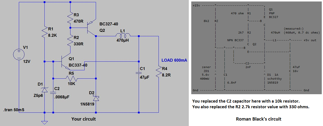

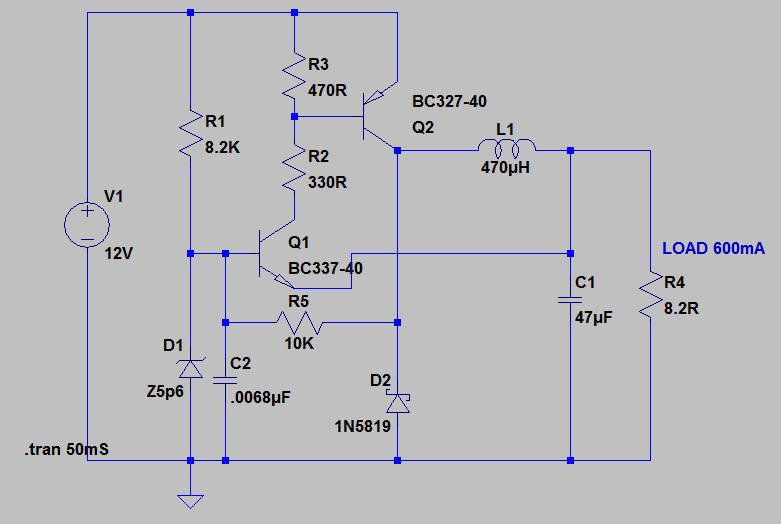

I made this discrete DC-DC converter. 12V to 5V converter, & I need 600mA of current.
The problem is Q2 transistor is getting extremely hot.After I changed it to BD140, But that also getting extremely hot within seconds. I changed couple of different value inductors as well, but Nothing helped.
How to solve this heating issue?

I made a discrete boost converter once on similar lines. It made a huge difference to performance (and therefore efficiency) using switching transistors instead of general purpose ones. Though to be honest your circuit looks as if it will change frequency and duty cycle if the output cap is changed or the load is changed, which is never good.
Better to use a chip like MC34063 (which has the advantage of being extremely cheap and very easy to use), much more efficient than a linear regulator and takes up much less space than a discrete design. Depending on your use-case you might want to set it of over 5v and put an LDO on the output.
I havent looked right into this so I might be wrong, however:
The Bc327-40 appears to be a high gain variant, 250, the Bd140 has a low gain around 25.
So I'd say the '327 in the original design is saturating properly while switching, whereas the '140 is probably not saturating and operating in its linear region hence the heat.
Capacitance might also be an issue being a larger tranny, this'll slow down switching speed, increasing dissipation.
R2 will need adjusting at the very least, and you might need to replace Q1 as well.

Very good info too.I made Roman blacks design.He uses the same.But I changed his feedback capacitor to a resistor & REduced the R2 to 330R.
Here what he has done.
https://www.romanblack.com/smps/smps.htm
I don't know how he has got 800mA test results from the same circuit with BC327.

I got the boost design from RB as well, tweaked it a bit too. Educational but I wouldn't do it again.
I think changing the feedback capacitor to a resistor messed up the circuit.

In Roman Blacks circuit he used a feedback capacitor and a high value of R2.With that parts I cannot even a put a small load like 150mA, because the output voltage drops down significantly.
That's why I change it to a feedback resistor and a low value R2.
Now output is steady, but the Q2 is really hot.

What did you expect?, it's not a working circuit any more, why would you expect random component changes to continue working properly?.
As far as the original circuit goes, I've always thought it's a bit 'iffy', as it is relatively simple for what it does - so any changes are likely to seriously disrupt it's operation.
Why mess about?, just buy a cheap ready made module from China.
Every part in this design is critical for current limiting, relaxation frequency and startup-efficiency . The feedback cap could be improved with a series resistance to raise f and shorten Q2 surge pulse.
This includes Q2: hFE and GBW which are tradeoffs, L/R=T1 , C1*ESR=T2 , R5C1=T3 and C1/C2 ratio There are advantages to reducing LC product to raise frequency while maintaining rt(L/C) ratio for ripple impedance.
I tried a very precise simulation of all passive parts with sliders for ESR,C2,L,DCR,Rb,Rf,Cf and this was my conclusion. There will always be a tradeoff between overheating Q on startup or load regulation stability or excessive peak current. The feedback cap drops the zener voltage and there are critical time constants that make everything interdependent. Especially when high hFE drops to 10% on saturation.
Generally, these "special minimal" designs cannot optimize every tradeoff. and you will always find a bandaid with higher ESR or much lower L and be wanting current limiting features added and soft start.
Conclusion, get a more stable complex design like an OKI 3 terminal Buck regulator.
