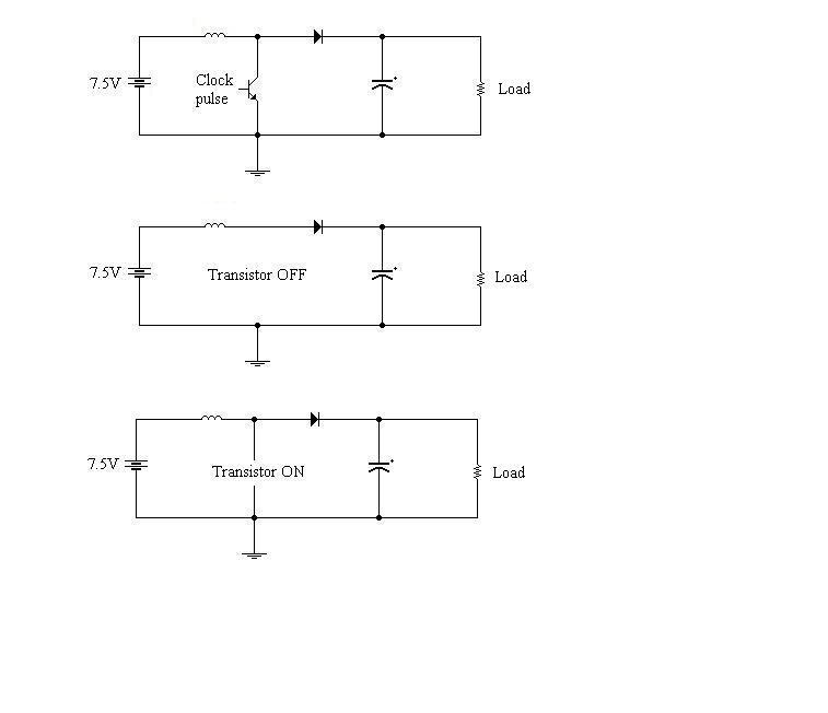

Sorry if its not right but I was thinking of the following operation:
Where if I were to use a transistor as a switch to generate ON and OFF instead of having a manual ON or OFF switch.
Coz I thought when the switch is ON, the current will flow across the inductor and causes the current to increase? Then when the switch is OFF, the current will charge up the capacitor to a voltage higher than the input voltage?
Meaning, to have somekind auto charge and discharge of the capacitor thingy. Is this wrong? :oops: Mind correcting me? :cry:
If I can apply the attached circuitry, any advice regarding the following matters?
a.) How do I determine the appropriate value of the capacitor as well as the inductor? Can I use approximately 10 microFarad for the capacitor? As for the inductor, is approximately 100 miliHenry an appropriate value?
b.) Issit advisable to include a zener diode in parallel with the Load as well as the capacitor?
c.) Should I boost to a voltage level of 15V for charging purposes in this circuit?
d.) With an approximate current value of 40mA, power output of 0.3W, voltage output of 7.5V, can this circuit be operated?
Thanks...

Nice try .. but it seems like you are trying to get something from nothing .
i thought we allready decided that the best /simplist method to charge the battery with the solar pannel was a diode..!!!

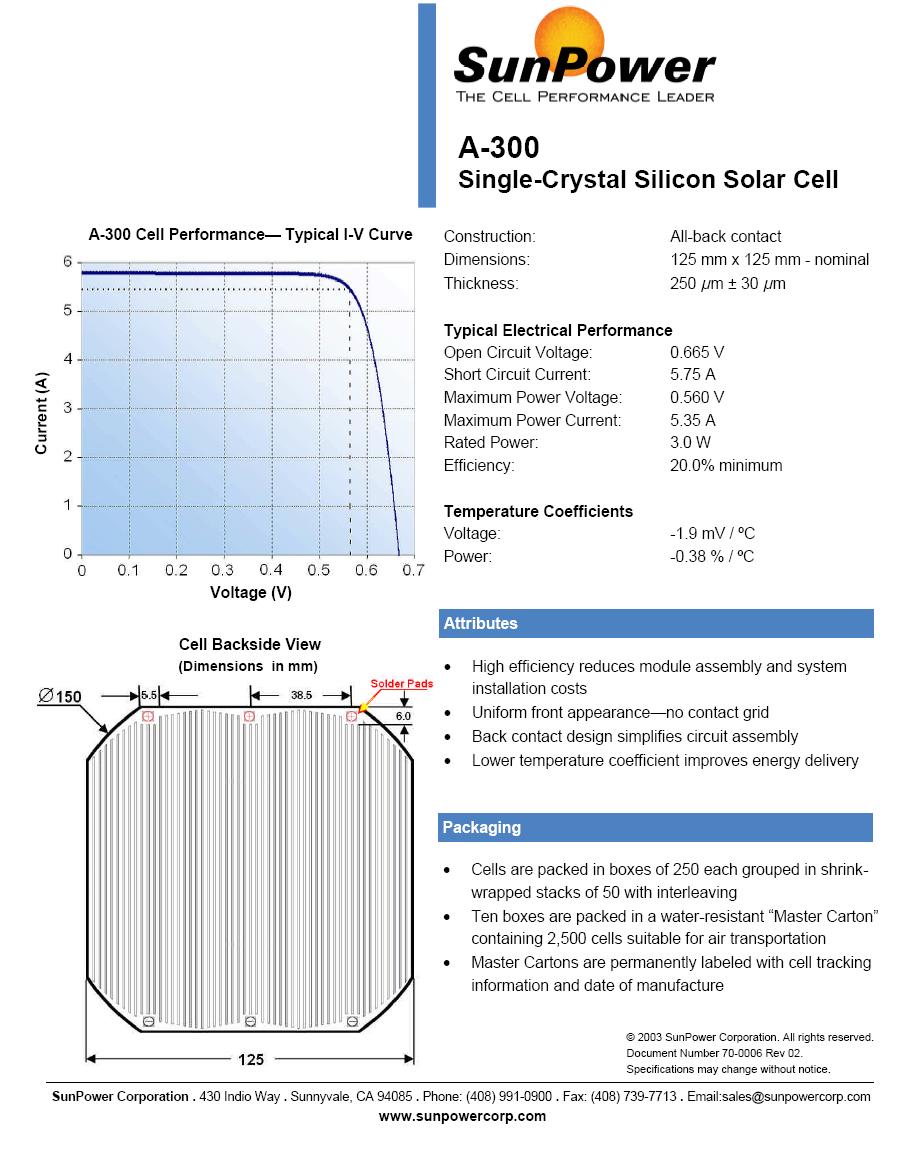

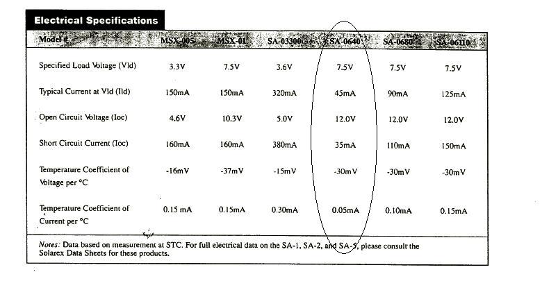

Sorry, here is the other spec sheet...
Guess there is something wrong with the short circuit current. Is there a mis-print? Isn't it suppose to be higher?
By the way, just asking...not for the project. Just asking if the solar cell is available in the market, the attachment entitled SP. Issit possible to step-up the voltage to a level of 14-15V for battery charging purposes?
Through calculations, I get a value of Duty Ratio of 0.96. Is it possible to have a Duty Ratio of approx. 0.96 for the DC/DC boost converter?
Looks like it to me!.
And yes, it was the physical size I was asking about, but I see the panel you've circled is only 330mW. I also don't see the relation between that spec sheet and the previous picture?.
Yup, I posted two pieces of spec sheet actually. The first one is, entitled SP is a single crystalling solar cell which provides good outpput whereas the other spec sheet, SP2 (circled) is the regarding the solar panel which has the output of 0.3W. About the SP2 spec sheet, I will reconfirm with the distributor as soon as possible regarding the output short circuit current listed in the SP2. It states that the output short circuit current was 35mA, which is lower than the typical current and load voltage. Is this a mistake?
Regarding the physical size, I thought another aspect to look into would be the duration taken to fully charge the 12V battery?
Can I put it in this way? By just using one solar cell (spec sheet entitled SP, the dimension as stated in the spec sheet), I will be able to charge the 12V battery in approximately 1 and a half hour?
As for the other panel, (SP2 with one panel's output current at load voltage is 45mA) by using a total number of 5 units.
So => 45mA X 5 = 225mA
Thus => 6400mA / 225mA = approx. 29 hours
The size of a unit is => 150mm by 55mm. Thus, the size of a total of five units of this panel would be around => 150mm by 275mm.
Hope this is what you want.
But there are other solar panels that will provide a better output compare to the one circled in SP2. Just like the column, SA-03300, on the left of the SA-0640. In which this unit is approximately => 150mm by 110mm.
