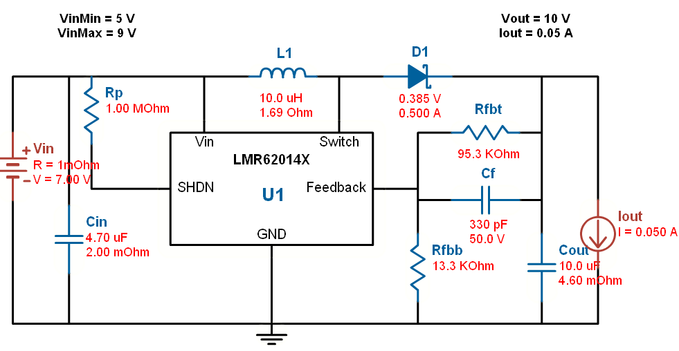

Thanks for showing me that schematic. Does this boost converter become accurate at very low current outputs as well? I'll need to check the datasheet.
For this schematic, where is the power source coming from? A 9v battery or a power box? I see the Vmin is 5.
My power source is a 9v battery, so I'm assuming the minimum for 9v battery is +-10, which is I think 8.5v as min.
You have the voltage min there at 5. Since there is 9V max, shouldn't their be a +-10 of 9, which is 8.5v as min?
The software I used asked for Vin min and Vin max. I just entered numbers. Probably 8 to 9V would be fine. If you let your battery discharge too much it will likely leak with some time.

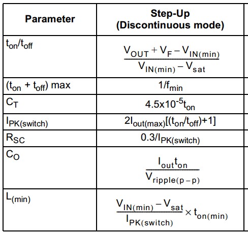

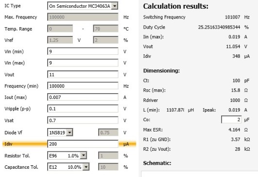

I'll turn on my oscilloscope and check the peak to peak current right after the battery with the 10uF cap. My measurements and calculations for the mc34063 (step-up) are based off the equations in the attachment. Theres also my older calculations for the schematic I first posted. Not sure if that calculator is accurate or not.

The series resistance of the coil must be less than the Current Sense R to get any accuracy on predictions. This drives the inductance down from 1mH to 10uH~100 uH for sub 1 Ohm Rs

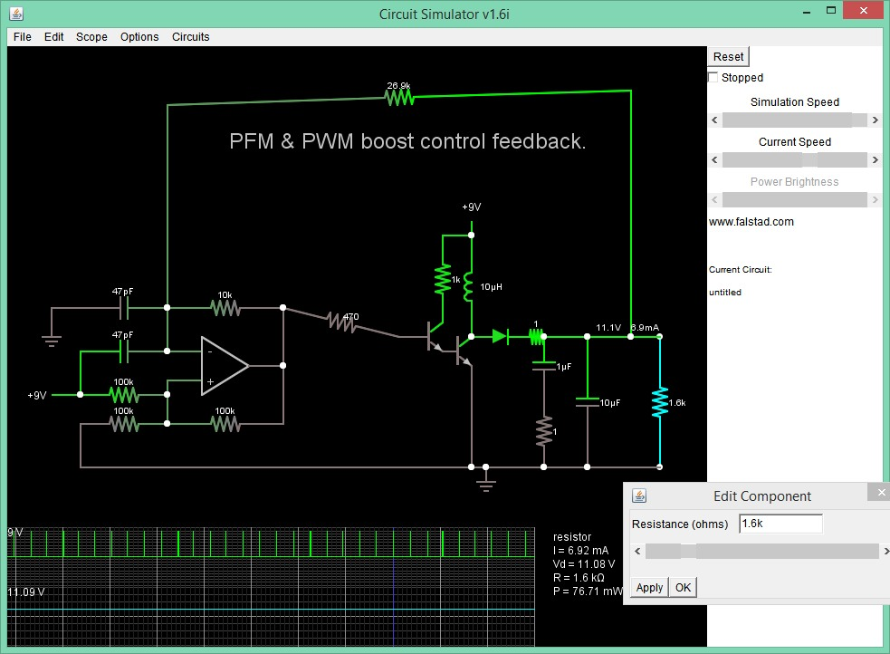

Here I simulated the essence of the circuit using a Hysteretic oscillator and same Darlington and a 10uH inductor.
The Pull up-down cap stores the initial and final voltage which are the same (V/2) to eliminate under/overshoot on startup. ( Press Reset)
allow Java here
Feel free to edit the values. ( enlarge window, change Load R and current, ESR included in Cap for realistic effects. Change anything you want) ( rt click edit)
