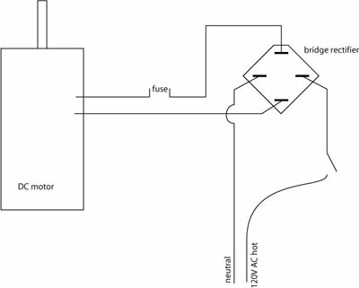

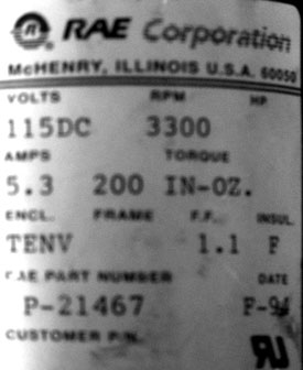

Hi, I have a DC motor that I want to make a variable speed controller for. The motor is a 115 volt, 3300 RPM, 5.3 amp, permanent magnet, brushed motor. I have it hooked up to 120 volt AC through a bridge rectifier, which seems to work well, I just need to get a variable speed control hooked up to it, as I am using it to drive a potter’s wheel. I tried a variable speed controller that I bought from Grizzly, but it didn’t work, probably because it is made for routers which are universal motors (?) and not the same as the motor I am working with. I’m not well versed in electronics, but can build to plans. Anyone have any ideas?

Hi, That motor does not seem to have very much Torque @ 200 in-oz ,you might be better off to gear it to the speed that you need with a large pully on the table and a small pully on the motor, that will increase your motor power and slow the speed down for you, make it belt driven, just my 2 cents worth :)

Thanks, Chellie, those look like they would work. I guess my 5.3 amp motor is too high amps to use something simple like a rheostat?

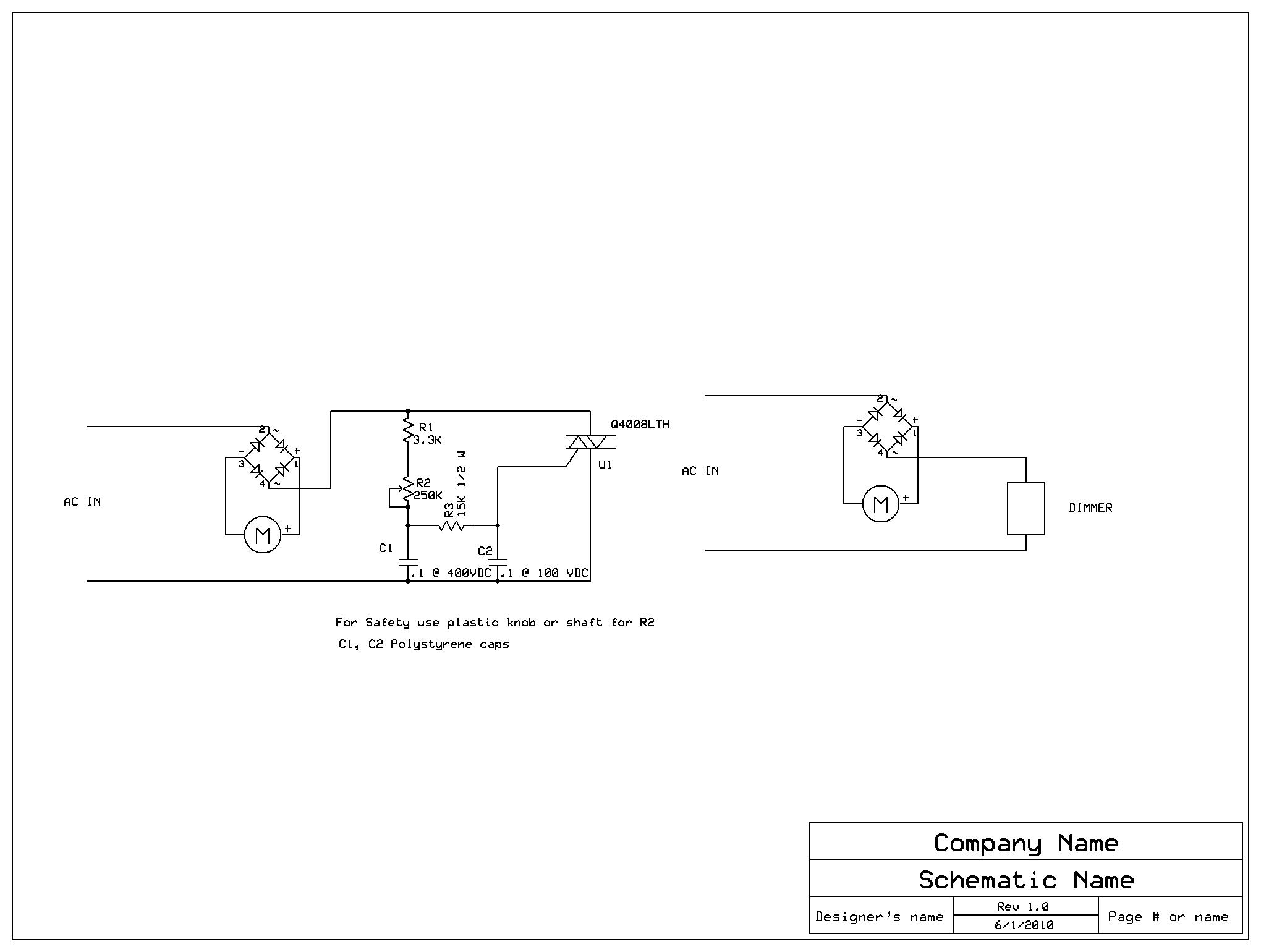

I was about half way thru this schematic when I thought "wait, this is a dimmer". So here are 2 possibilities. One is a DIY project for about $15. The simple one is to go to Home Depot and buy a $15 dimmer to add to your bridge. Hate to admit it but the dimmer is probably better - less fun, but better. Let us know how it comes out.

do not use a phase control for a DC motor... you need over $100 in filtering to get it to work. oh it will work, for a while. it will pump out 120 hz noise and pit out the bearings too!
you are talking about a 16mH at 10A inductor and a 2200uF lytic capable of handling the ripple current to filter a phase drive for a 5A DC motor.

It's quite common to drive dc motors using this approach. It is true their may be a little hum under load and the electrical noise is not trivial. That's why the dimmer is a better approach because it will have filtering to make it pass FCC.
hate to break this to you but the circuit in the OP IS a dimmer! a standard BDC motor makes a hell of a racket and grands away it's bearings driven by a dimmer. a universal motor on the other hand might be a little better off.

actually i recommend you use PWM ... phase control will burn out the motor bearings unless you put a huge filter on it. if you want to filter the PWM it takes smaller parts since you are at higher frequency. 16-20KHz is common. if you use a filter with 100KHz you can use reasonable parts for filtering - around 50uH and 10uF where as at 120Hz (60Hz full wave rectified gives you 120Hz at the motor/filter) you need 16mH and 2200uF

That is a lamp dimmer with a couple limit pots and a rugged thyristor, and it WILL wear out the motor bearings. 200% current limit? BS! once a TRIAC fires there is NO CONTROL until the cross over allows it to turn off! And I do not see anything resembling an IC to do the actual control ... there is not even room enough there for a stupid little 8 pin chip
worst case is at 50%. think about it... you have a motor at half speed and every half cycle you apply 170V to the motor. that effectively slams the shaft into the bearings 120 times a second.
