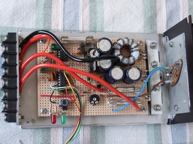

Hi! I need help designing a circuit to boost a 12V DC source...a vehicle battery from 12V DC to 13.8 to 14.5 volts DC to charge an RV battery.
Problem: Current charging circuit = 40' of #12 cu. 20' in length and 40' of #8 cu. 20' in length. Voltage drop through this circuit is too great to allow adequate charging of RV battery at end of line.

use a dc-dc converter (switch mode boost)
if ripple is too high connect external inductance to cct

Using thicker cable will probably work out cheaper than adding a boost converter.
Why would you boost the voltage instead of connecting a battery charger to the RV battery directly? The wire guage you specified is the same as that used on booster cables and industrial rapid chargers.
Hello, I realize this is quite an old post, but where you able to solve this issue. If so, do you have a complete diagram of your RV charging system that could be made available?
I built something similar a few years ago. I've attached the diagram and PIC source code. It has worked flawlessly for around 4yrs and we go camping often. It can supply a max current of 15A at 14.2V to the battery with apx 12V input after wiring voltage drops. If you decide to build it, I can supply more details about the coil, etc.
The reason I went this way, rather than use thick cables, was that I wanted to use the standard trailer connection to my camper and not have to unbolt #0 cables every time I wanted the camper off the truck. If you unbolt heavy cables connected to a battery enough times you'll eventually weld them to something grounded like the truck box!

It is designed to go between the vehicle battery/charging system and the RV battery. The vehicle alternator charges the vehicle battery and also supplies current for Vboost. You cannot drive it with just the alternator alone which would be redundant anyway since the alternator can output more than 18V on it's own.

alternator -> engine battery -> vboost -> battery service

Draft Kchriste turns the alternator charging real charger with boost phase (14.2 V) and maintenance phase to 13.2 V. is a great project to par with commercial ones like:
**broken link removed** 20SCHEDA%% 2030% 20A.pdf
The charging system of the engine battery is only for recharging the battery of the motor that is not subject to deep discharge (to the max is at 90%). That service, however, when it is profoundly low (less than 50%) can not be recharged with the only constant voltage of the alternator but needs at least two phases.

I am very interested in building up this project of yours. I would appreciate it if you could supply me with a more info the coil design, ferrite details(manufacturer and part no), wire guage and number of turns. On your schematic what do you connect your Chrg input to as you already have a battery connection?
