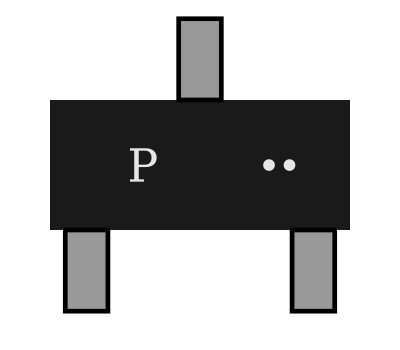

Hi.
I spend some time struggling with working out a correct schematic for a fan controller (inside the fan itself). Reason is that all wires into the fan is pulled out with force, making it almost impossible to find out what is positive terminal and what is ground.
Also, I would have make it easy if I was absolute sure about the pinouts of the mounted transistors on the printboard. But I'm not sure about pinouts.
I have drawn a simple scetch on how the transistor is marked.
Generally, the P leg is the Base, The ".." leg is the Emitter, leaving the lone, opposite pin the Collector.
Yep, they are BCE left to right, same as a lot of common power transistors like SOT-223 and even through-hole ones like TO-220 etc.
Likewise FETs are pin compatible being GDS to match BCE.
