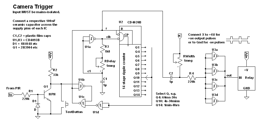

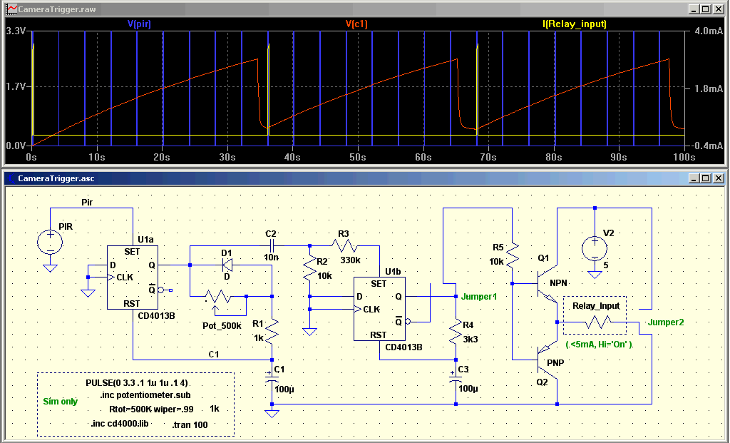

Would this meet your needs? Multiple triggers of the camera are prevented for a delay time adjustable up to ~32 sec with the components shown.
The output stage is a push-pull one using Q1 and Q2 to enable the relay input circuit to be pulled high or low (selected with jumpers 1 and 2) as required at several mA current. In this regard the website spec for the relay is unclear in that it says the relay turns on when the control input is high, and is TTL compatible. However, TTL source current in the high state is only ~0.4mA; which is less than the required ~3mA needed to turn on the relay :confused:

Here's a more versatile timer. If you use the Q10 output of the 4020 IC the RDelay potentiometer will enable you to set a delay from ~4sec to ~30mins between successive output pulses (camera clicks). If you use the Q14 output the delay will be 16 times as long (~1min-8hrs). RWidth enables the duration of the output pulse to be adjusted (~50ms-1s) to suit the relay/camera.
Edit: I've included a test button so that you can set up the timer without the need for the PIR sensor being attached.

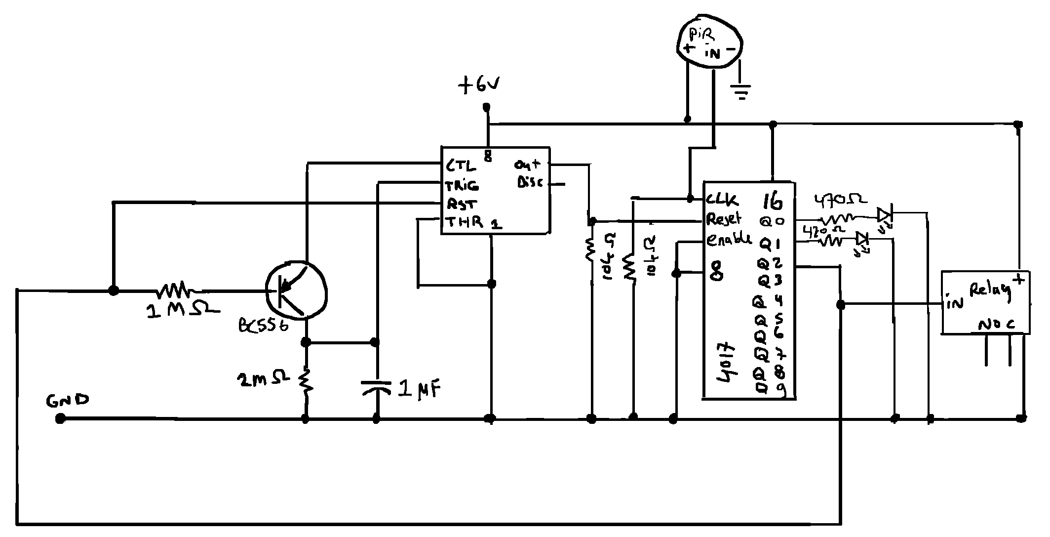

Why are the PIR and the 555 both driving pin 14 of the 4017 (via diodes)?
Pin 14 has no pull-down resistor to ground, so will be left floating when the two diodes are not conducting. CMOS ICs can behave erratically if inputs are floating.
BTW it would be helpful if you could post a schematic (even a quick pencil sketch would be easier to follow than a breadboard layout).
Here's a diagram of the new construction. Seems to work without errors. The counter only resets to one instead of zero:(. Ordered the parts for your second circuit.. may take a couple of days before the items arrive. I will let you know when I have (tried to) put it together..
Because I couldn't get it working any other way.
