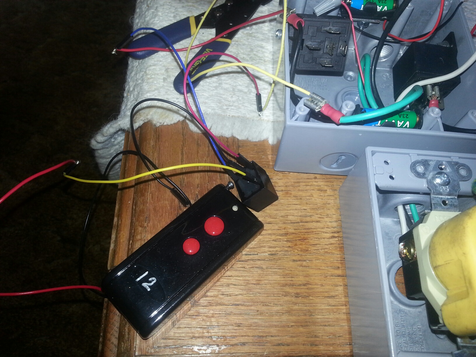

Here is how the box is hard wired. Inside a juntion box, there are two relays - one for each machine. 12v is supplied to terminals 85 and 86 for each relay. And on terminals 30 and 87 goes out to the machines A and machine B.
For a test run, I am able to get the wireless remote to work on side - lets called it machine A. I keep the 12v running to pins 85 and 86 and pins 30 and 87 are now connected to the wireless transmitter. The receiver is connected out in the field on machine A. For a test run, when I press button A for machine A - the wireless remote works perfectly. When I go to install the other wireless remote in the same box for machine B I hook it up the same way - it works fine when I press button B - machine B launches. Here is where the problem lies - when I press the pair button - only one machine launches - the other machine does nothing - acting if the signal was cancelled out. They do run on the same frequency - 350MHZ. So then I thought what if I put a 555 timer delay on one remote to delay the signal for 1 second hoping to still trigger both machines off the pair button. That is where I am having probems.

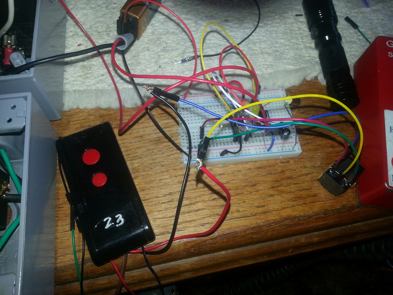

Here is how I am tying in the 555 timer to machine B. On pin 2 of the 555 timer, I have the input signal coming from the handheld control unit. The pin 3 is the output and I have it running to my relay pins 2 and 5. Pin 2 is + and Pin 5 is GND. Then I have wireless remote connected to pins COM and Pin 4 NO on the relay. When I press button B on the handheld control unit the 555 timer runs through it rountine and the relay is held open for 1 second. But when I press pair button, still only one receiver goes off.

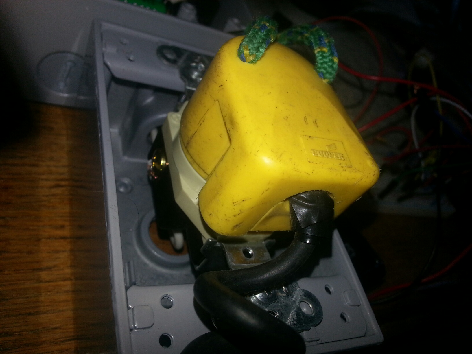

I don't know how much the pictures will help, but I took 3 pics. yes the wiring is ugly at this time, but it will definitely get cleaned up when I get the final results.

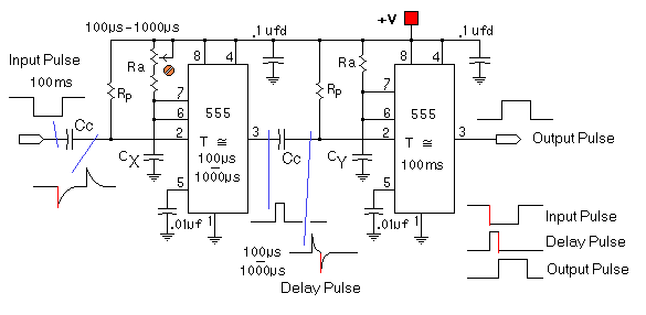

If you can tolerate a half second gap or so between the "simultaneous" launch, then that can probably be done with a 555 or two. Here is a typical delay using two 555's:
The resistor and capacitor values need to be changed to get the timing that you want. If you use a relay for sending the second launch signal, the delayed pulse could actuate that relay. If you want to avoid the relay, then you may need a simple inverter or a different circuit. In either case, it will not be much more complicated than the circuit posted above.

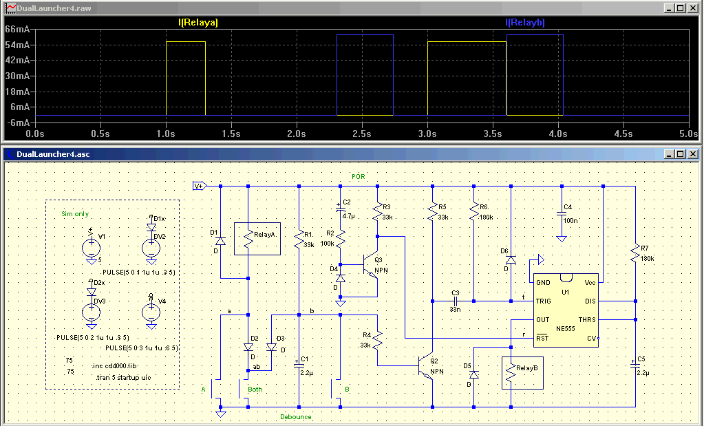

Here's a possible solution if your switch-buttons are the type which connect to ground when pressed:-
  • DualLauncher4.asc
