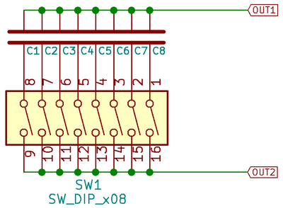

Hello,
I thought that DIP switch were like normal switches but less capacitive and smaller.
My schematics with 1 8way DIP switch (in this example eight capacitors are 10pF):
If I active C1 swtich, 10pF will be added. If I active every switches, there will be only 10*8=80pF isn't it?
Or maybe there's a thing that I don't understand...
Thank you AJ

Binary!! - make C1 = 1pF, C2 = 2pF, C3 = 4pF and so on.
If I actived C1 swtich, 10pF will be added. If I actived every switches, there will be only 10*8=80pF isn't it?
Using the same cap on each switch is the least effective way.
Use eg. 10, 20, 40, 80, 160 etc. for binary steps; by selecting the correct combination of switches, any value can be set in multiples of the smallest value, up to (double the largest - the smallest)
or, 10, 20, 20, 50, 100, 200, 200, 500 etc.
that translates to decimal digits rather than binary and again any value can be set in multiples of the smallest, to over double the largest.
Oh okay!!
I understand now. I remember in studies I've used a DIP switch to control DMX adresses on a scene light, and it was like binary.
This solutions sounds even cooler!
Thank you I'll try like this I'll give you the news.
