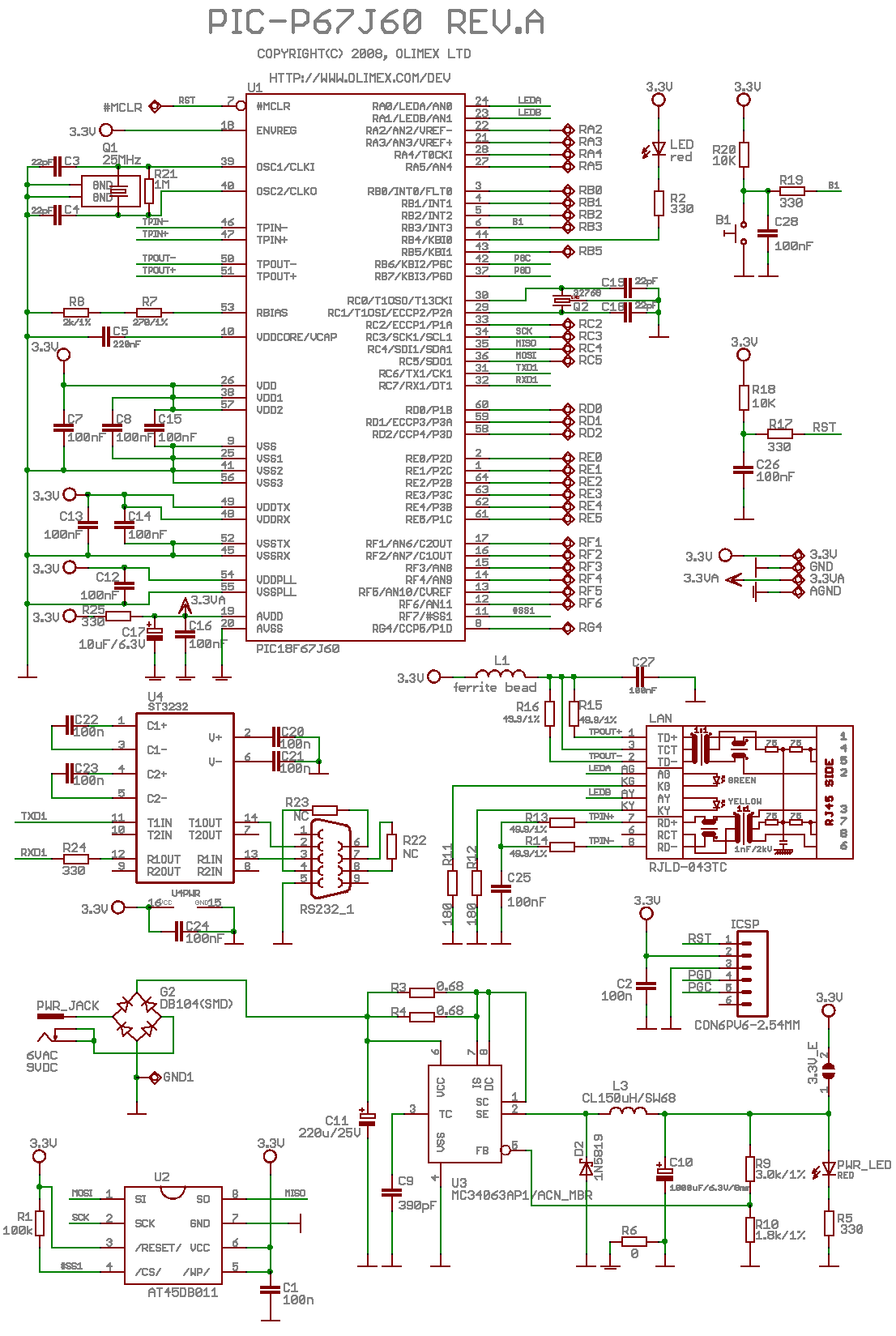

As of today the current I/O and pincount (we have 39 on the 18F67J60)
I/O required plus description
16 Two 8 bit I/O conectors (2x5 jack or 10 pin inline undecided)
2 ICD & SD RW & Insert (jumper selectable) PGC & PGD are 5V tolerent so will work with Junebug / Inchworm / PICkit2 / ICD2 etc...
2 Ethernet LEDs
4 SDCard (SPI)
4 RS232 EUSART with CTS / RTS
2 RS485 Software UART
4 XBee Software UART with CTS / RTS
4 25MHz & 32,768Hz crystals
Total = 38
One pin left... what to do? LED, iButton, analog input, interrupt input, CCPx I/O, 433MHz RF TX or RX?
A typical PCI18F67J60 design looks like this one from Olimex (pdf attachment)
