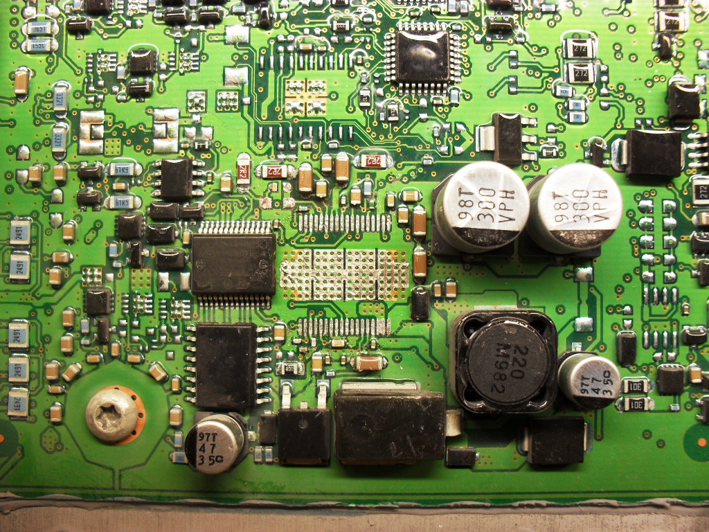

desoldering SMD DIP IC with a heat pad....
OK.
The part is dead. Grind off the plastic and get to the metal. You can heat that!
BUT
If you can't heat the part to melt the solder underneath then you will never be able to solder the part back on. If the solder on the heat sink is not right the part will get hot and die again.
Preheating the board will not involve melting the solder on the chip components on the rear of the board. Stick the whole assembly in the oven for a half hour at 150 degrees. Take it out and immediately remove the chip with your hot air wand. That way you are only requiring to raise the chip by the delta temperature in order to melt the solder. You may find that there are some glue dots below the chip too, if there are, you will need to twist it slightly back and forth before lifting it off.
Success! Indeed, the preheat was the answer. I had already determined my issue was the fact that the big Aluminum case must be sinking all heat so I need to get the case hot. I took it to 150F (Hotter prob would be even better), and with the hot air at 480C and my 40w iron at 480C, it took about 30sec to release. Hardly any solder there at all. Looks like I escaped pad damage too and I do not see compromise of other components. However, I know I got a few things pretty hot! Specifically the caps to the right of the chip. How hot is really the question but they are still meter testing decent.
Also, not sure if this trick I figured out is common knowledge but I dipped my solder wick in flux paste (just the tip) and it seems to do 10x better. I can run a sweeping motion and sops things right up with much less heat.
So.... to reinstall a chip, this will be really tricky. I know if I get too much solder, it will bridge some pins. I want to use a lower temp solder for the sink. I am hoping I can figure out a way to get it done. I think I will need to solder the sink first, then move over to the pins and probably manually solder each one by tinning the iron only.
Thoughts on the process?

Method 1, my first choice:
Meticulously clean the board, pads etc of any glue, old solder or flux residue and liberally flux it with a flux pen once clean. Run a couple of fine lines of solder paste towards the middle of the heatsink pad, but away from the edges and not too close together to allow it to spead out under pressure. Clean and flux the mountnig tab on the device. Again, pre-heat the assembly and drop your device in place, put a little pressure on it and hit it with your hot air wand until you feel it seat and settle. Keep the hot air on it for a little longer than you think is too much, to ensure that capillary action pulls the solder all around the pad. Let it cool and then solder up your pins after giving them a rub over with a flux pen. Clean the assembly afterwards of any and all residues left over.
Method 2, not my first choice:
Failing that, and this method assumes that you will not be attempting this again in the future, you could use a tiny amount of Chip Bond (Silver loaded epoxy), again spread around towards the middle of the pad to allow for some expansion under pressure, to bond the device back to the heatsink pad. If you do this, forget about ever removing the device again, it's very unlikely to come back off without wrecking the board in the process. Also, don't get it anywhere other than exactly where you want it, it conducts quite well and will be virtually impossible to remove from unwanted areas. Leave it to set up and cure over night with a little piece of tape holding it in place so that surface tension can't move it, then flux your pins and solder them up. You could also just solder tack two diagonally opposite pins to hold it. Again, clean the board of all residues afterwards.

You would be surprised at what hot air temp you can get away with. The balance is temperature vs time. The chip and board will need time to get up to temperature, enough to melt the solder on the heatsink pad, and the higher the temperature, the faster this will happen. But it will also mean the temp of the chip will rise faster than the board. I tend to use around 420-450C hot air, with a nozzle about half the size of the body of the IC. I do not know if this is the preferred way, but I have reused many parts and they function fine.

Well, again, the sink is primarily what I am stumped on. Since I had to grind out the center to get better access to the pad, I would get to do that with the new one. One option I discussed with my bro is silver paste rather than solder? I realize this would not be a true bond but would not require heat. However, in most cases where that is used, there is a mechanical means to keep contact pressure.
I would not expect the board to operate anything over 100C normally.
I might like to get a few more thoughts to recap ideas for soldering the pins. I originally considered just lightly tinning each pad, then sit the chip on after fluxing the feet, and just touch each foot with a little heat to sit them down. However, I can see where that might present a few issues. Once I have attached the heat pad, I don't want to have to remove the chip again due to bridges. Remember too that I have tons of tiny components very close to the feet of the chip so too much heat will probably cause issues.

1) Thermal conductive epoxy. LocTite also makes something similar. I used the LocTite product (McMaster Carr) for some high-power mosfets. I also just soldered the same to copper bus bars (0.625" x 0.025" x >6" long) with no problems.
2) Low-temperature solder. Bismuth alloys are available with with melting points from 58°C (ChipQuik removal alloy) to 138°C (Sn42/Bi57/Ag1), as well as other temperatures.
3) A paste, either silver or diamond.
With any of the solder options, you could rig up a low-voltage source and simply heat the tab as a resistance element.
I would tend to go with the low-temp solder and flux, since you already know you can pre-heat the whole board to 150°C. I would then use regular tin/lead solder for the pins and not fuss with resistance heating of the tab.

I probably won't use the epoxy just due to the no rework problems. I don't plan to do this again but I also am not yet sure how the chip failed in the first place.
The paste I was considering is not a solder paste but just a conductive paste that is common to components such as the TO-220 package. I am not sure without a mechanical pressured connection, if that is wise.
I am leaning towards a lower temp solder for the heat pad. Can you recommend something? I think most solders today are around the 180C melting point. I would like to see something around the 125C range?

I didn't mention before, but I would not try doing this with hot air. Hot air can heat a large area and can be quite hot, but it is still subject to the relatively poor thermal conductivity of air. Thus, when trying to heat something on a heatsink, it can be defeated. A nice soldering iron with a bit of molten solder will give better localized heat. Get yourself an 80W with chisel tip. Mine is ancient and rarely used, but when needed, it's the right tool. I run mine from a Variac so I can keep the tip from overly oxidizing.
