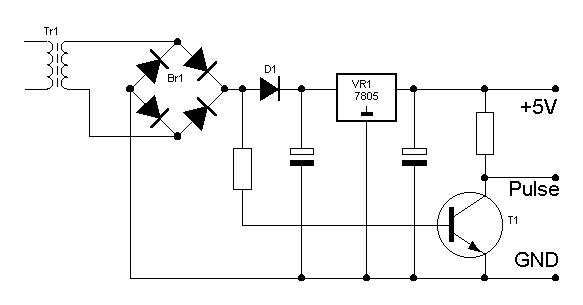

Quick update, here's a simple circuit to generate zero-crossing pulses in the PSU of a PIC circuit. The pulses are positive going, will start just before zero-crossing, and end just after, with the zero point pretty well in the middle. However, it's perfectly satisfactory for triac control of faders etc.
If required you could always tweak the software to give a slight delay after detection of the rising edge.

Nigel, just out of general interest, isn't there a 90 degree phase shift between the input and output of a transformer? If so, how does that affect this zero crossing detection scheme?
I don't know? - if I get time I'll dig a transformer out and measure it. But this sort of circuit is commonly used to generate zero-crossing pulses.
I've dug out a 30-0-30 toroidal transformer and tested it, the primary and secondary are perfectly in phase with no load!, or with a 48 ohm load (2 x 24 ohm 17W in series).
O.K. Thanks. I've no idea where that notion came from, probably something my father said 40 years ago that I misconstrued!
Transformer phase-shift
Just butting in to confirm ...
there is NO voltage phase-shift across a transformer, if there were the power generation and distribution systems would be a mess - we rely on known phase angles when switching massive systems in and out.
Maybe you are remembering something of the AC current being out of phase with a voltage? (pure inductance gives a theoretical 90 degrees phase lag ?)
Actually, to be pedantic, a single phase transformer can give a 180 degree shift if primary or secondary terminals are reversed.
