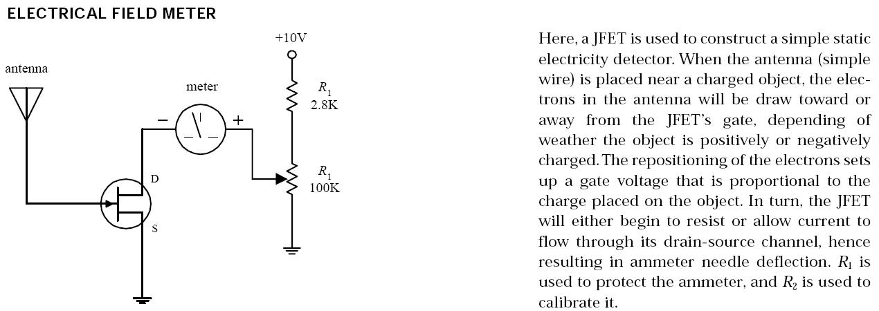

I dont know if this will be of any help, but here is a simple circuit i found.
