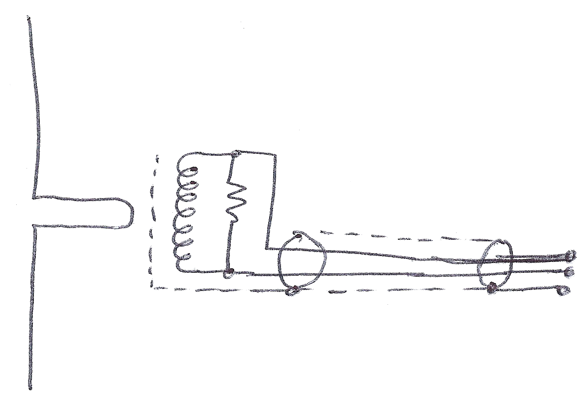

Looks like three wires from the CT.
The right two will have 2 to 10 ohms resistance. (don't really know the resistance but it is mostly the wire resistance in the transformer)
The third wire might be a shield that should be connected to the computer's ground.

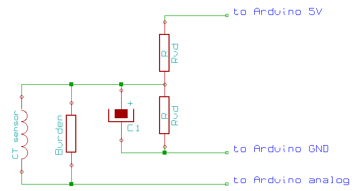

I think the confusion in this set of posts is does the intrinsic CT have a built-in rectifier so that it produces a DC voltage (more or less) proportional to the AC current, or if it lacks the rectifier, and just makes an AC signal of a couple of Volts across the burden resistor?
If the former, then connecting to an Arduino ADC pin is trivial, provided that the DC signal stays between 0V and 5V.
If the latter, then there needs to be an interface (consisting of bias supply, a diode, possibly an opamp, resistors, capacitors) to convert the AC voltage across the burden resistor to a DC signal so that a single ADC reading gives a value proportional to the magnitude of the AC current.
Alternatively, the AC signal has to be biased to 2.5V (to put it at the center of the ADC's range), and then take lots of ADC samples for each period of the AC waveform and use Arduino software to convert the series of readings into a single value proportional to the magnitude of the AC current in the primary.

Here the "0 current point" should be at mid point of the ADC.
The voltage should be + and - from center. (AC)
There is a claim that the resistor is in the CT.
up to 16V AC
This can not happen. Something is wrong.

I have CTs like this:
Three wires. One wire is "shield". If the shield wire is not connected to ground of the Micro, then some noise will get in.

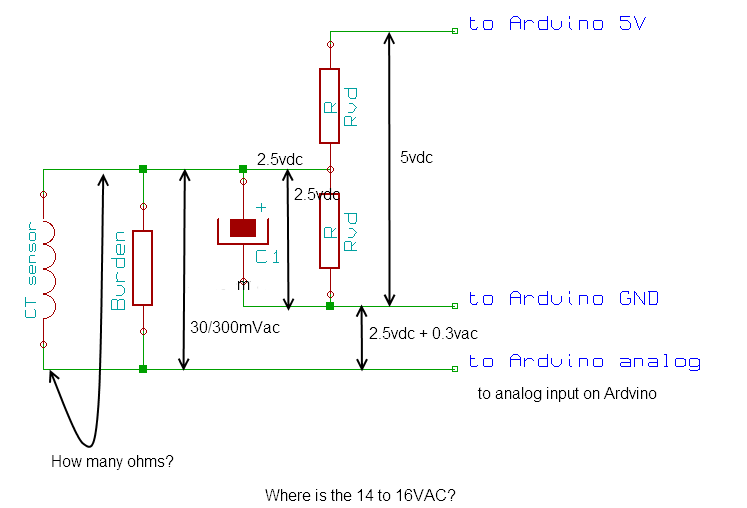

Thanks for reply, the output is AC, 300mV hence the circuit
upload_2017-5-16_10-44-38-png.106022
16V AC is not from the CT sensor, from CT sensor its 30mV to 300mV AC (for ON and OFF conditions respectively). 16V AC is what noise is on my circuit. So in above circuit, when I connect the pin labeled "to Arduino GND" to my circuit GND , connect pin labeled "to Arduino 5V" to my +5V rail and measure the pin labelled "to Arduino analog" with voltmeter(AC), the voltage keeps on jumping around 14 to 16 V AC.
If I measure the CT sensor output itsself, on its own without connecting to any circuit, it goes from 30mV to 300mV as stated above.
Hence my original post #4 regarding tip, ring, and sleeve which chrischris never bothered to respond to.

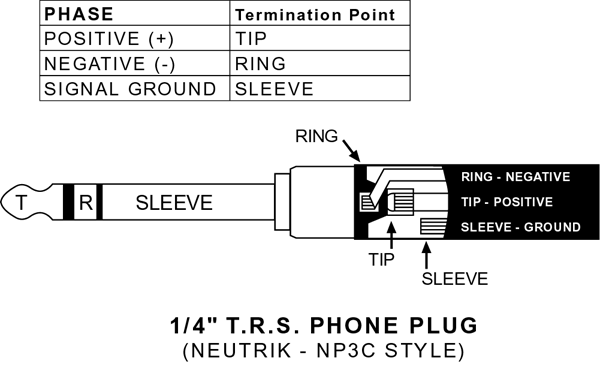

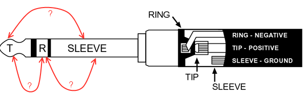

We are trying to find out what you did with: TIP, RING, and SLEEVE.
These three wires are connected to what? I think you are only using 2 wires of the 3.
We are trying to find out what you did with: TIP, RING, and SLEEVE....
Ron beat me to it. I found, and was going to post the exact same figure...
Big question:
What is the resistance of these three points.
My guess that two will measure about 20meg ohms and one will measure about 10 ohms.
Ok now I understand what you mean (feeling stupid!). There is a 39 ohm resistance between TIP and Sleeve, Ring is open circuit with respect to TIP and Sleeve.
I tried grounding Sleeve and now, the 14V AC noise is gone , but I don't see any reading on TIP or RING. Actually ring stays at about 4V AC regardless current detection and TIP stays at 12mV AC.
Surprising thing is that datasheet suggests 62 Ohm built in load resistance but I don't get 62 Ohm anywhere ?:banghead:
Any ideas please.
Thanks everyone !!
My guess is that you are just measuring the resistance across the secondary of the current transformer. This could be JUST the winding resistance OR it could be the winding resistance in parallel with the 62 ohm burden resistor. You need to test it properly by passing a known current trough the primary and measuring the AC voltage across the secondary with a 62 ohm connected across the secondary. If the voltage reading is lower than that expected then measure it again without the added 62 ohm resistor.
