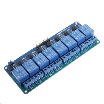

It's a very simple device, and cheap and easy to make one using a micro-controller - just a micro-controller, relays, drivers for the relays, and whatever controls you wanted (like a pot for the speed, or buttons up and down, and some kind of display is desired).
Dead simple to do with an Arduino (or anything else), plus one of these relay boards - up to 8 channels done for less than £10.
Biggest cost would be a box and connectors for it.
