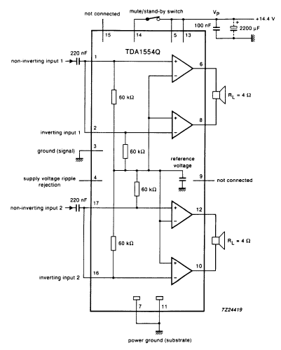

Many car radios use an IC similar to Philips' TDA1554 which is a quad amp that is usually used as a medium-power bridged stereo amp. They claim 20W per channel but it is actually only 14W per channel without distortion.

The tda1554 looks like an easier circuit than the LM386 I had first. As always my posts come with questions... What is the non-inverting input? Does the capacitor make it an inverting input into Pin 2. Also, what is the supply voltage ripple rejection? Are the positives of both speakers connected to the IC or the negatives? Thank you
ooh, another question I have with the transistor amplifiers. Can you switch a regular NPN or PNP transitor with a MOSFET? If are there different types of MOSFETs?
It is the input to each bridged amplifier channel.
Does the capacitor make it an inverting input into Pin 2?
The capacitor to pin 2 feeds the inverting input of the 2nd power amp for the 1st channel. Then the speaker is fed opposing signals which effectively doubles its voltage swing. Since the speaker's voltage swing is doubled, then its current swing is also doubled, therefore the amplifier's output per channel is nearly 4 times the power of a normal non-bridged amp.
It is the amount of reduction of noise that is on the power supply voltage that is heard at the speaker.
The IC has 4 power amplifiers. The speakers are connected so that the + of a speaker connects to the 1st amplifier and the - of that speaker connects to the 2nd amplifier. Then the two amplifiers are connected in a bridge to effectively nearly quadruple the power to each speaker. The 3rd and 4th power amps are connected in a bridge for the 2nd speaker.

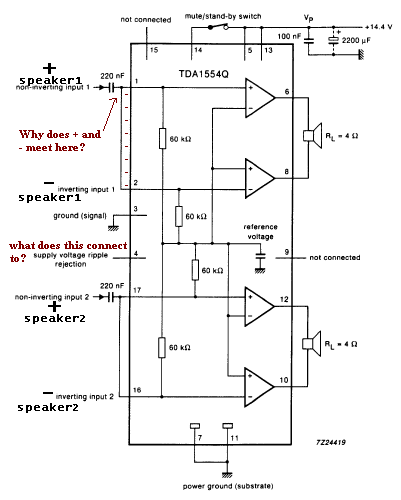

Can you connect two of these circuits together to make double the power or will the distortion be too great? Can you look at the picture I have below to see if it is correct. Thanks again
The left side of the amplifier is its two inputs from a stereo CD or MP3 player. The right side shows the two 4 ohm speakers connected to its outputs. Additional speakers will overload it.
I don't know why you want to connect more speakers at the amplifier's inputs. They won't work. Speakers connect to an amplifer's outputs, not inputs.
Actually, the speakers you added are across the input capacitors so the amplifiers will be totally messed-up.
I don't know what two circuits you want to connect together.
This is a stereo amplifier for two 4 ohm speakers. If you want more power then use a second amplifier with its own two speakers, or a much more complicated high-power amplifier.

ooh I messed up! I didnt mean to put '+ speaker' Just '+' (what I really mean is the output from a CD player). I dont want to connect the amplifier after the speaker (that makes no sense) Sorry I screwed you guys up. So non-inverting input #1 is from the CD player to the left speaker but goes through the amp first and non-inverting input #2 is the same but for right speaker. I can't believe I did that. I'm still confused as to what supply voltage ripple rejection connects to. As for the more power, I was wondering if you could connect the outputs of one amp to the inputs of a second one. I see now that you cannot because there are four outputs and only two inputs. Sorry again for confusing everyone.
Why not consult the datasheet to find the connections?, which (on a VERY brief glance) appears to show it only being used for a four channel application?.
There would be no point in putting power amps in series, you would only get the same amount of power out - and it would be horribly distorted. If you had an extra set of speakers you could use seperate power amps for each set, and get more power that way.

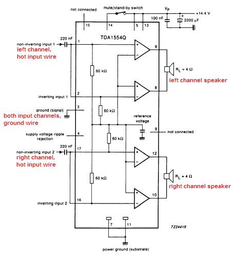

Is this wiring diagram clearer?
