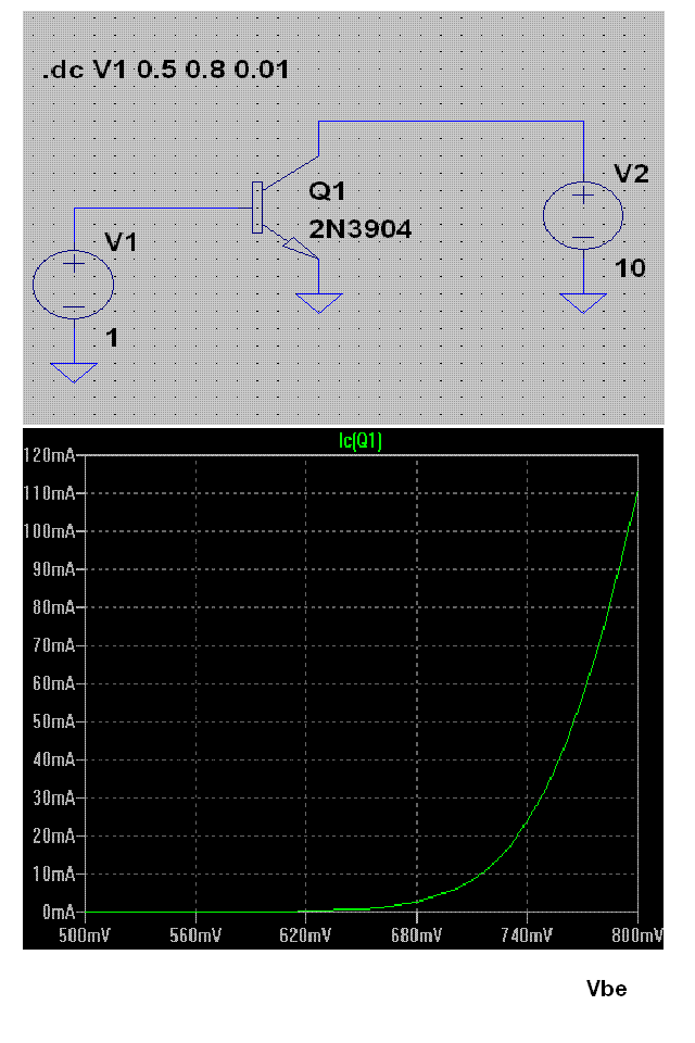

Actually they are both voltage controlled current sources.
The collector current in a bipolar is an expotential function of the B-E voltage.
Ic = beta Ib is more useful in practice but in transistor theory it is a consequence not an absolute.
One advantage of FETs is their very high gate - source resistance.
The attachments are a SwitchCADIII analysis of an NPN transistor. The horizontal axis is Vbe and the vertical is Ic.
Len

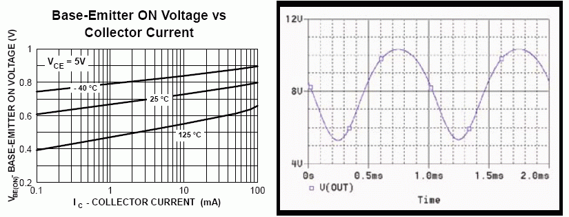

Yeah Len,
You show that a single transistor is very distorted without negative feedback. You also show that a push-pull transistor circuit has crossover distortion without a suitable amount of idle current.
For years I looked at the linear straight line on the datasheet but saw the conflicting distorted waveform on my 'scope. Then I realised that the "straight line" has a nice linear voltage scale on its left side, but a logarithmic scale on its bottom. :lol:

If you mapped your graph on to a linear/linear graph. it would be exponential like mine.
As you implied, for minimal distortion, the transistor has to be biassed correctly and driven correctly.
Len
