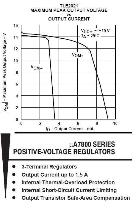

Hi Styx,
How do you get 80mA from the supply into a flea-power opamp that current-limits beginning at only 7mA? Its worst-case max shorted output current is only 20mA.
I think its 80mA max supply rating applies to the quad opamp, when all 4 of them have their outputs shorted.
Hi 2pac,
A 7805 regulator never smokes. If you short its output and it begins to heat too much, it automatically shuts-down.

audioguru said:
Hi Styx,
you would think...
Since I dint actually state whether I was using all 4 or not (hypothetical cct to point out that you should check the datasheets to give an idea what a component will draw).
You state that the 80mA might be max drawn WHEN the output shorted. However, in my experience it is not always the case. I have a RS422 driver chip and it states power into the supply pin and also max output power. I sized the 5V reg based upon the max supply current.
It then turned out to be under-rated ALOT (taking a redesign to go from a DPAK to a D2PAK reg). it turns out that total current inclused output current as well.
Yes bad wording in the datasheet, but I got burnt, now I summ up all the currents. Doesn't really matter since the load gov'n the amount of current drawn, if I over-estimate it, it just wont draw.
