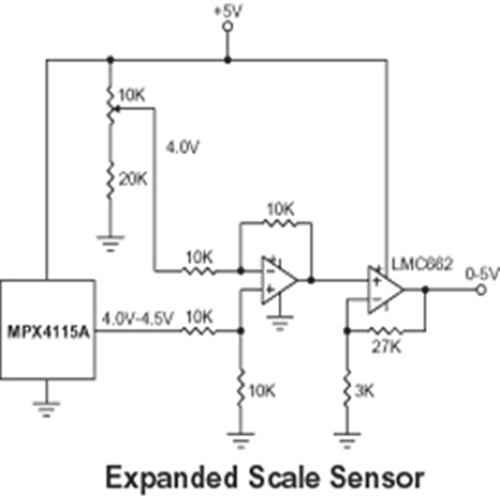

Check out the attached picture. The same exact concept as what you want to do. You want to provide the first op amp with your offset voltage(2.4815V) via the pot. This makes it so that when your temp sensor is at the lowest reading (when it outputs 2.4815V) the output of the first op amp will be zero. Then you set the second op amp to a gain of five to get the scale that you want. So that will give you an output from 0-5V with an input of 2.4815-3.4815V. The gain of the second op amp in the original circuit is set at 10, so you will need to change the 27k resistor so that it is a gain of 5.
The photo came from the **broken link removed** web site and the article was in the August 2006 issue in the Q&A section.
Vgain = (1+ RB/RA) Where RA is the 3k resistor and RB is the 27K resistor.

Thanks Sig239, exactly what I needed :D

I'm not having much luck here. I couldn't get any LMC662's so I have been playing with some LM358's. Is there any reason why these would not suit this application? I haven't connected the circuit to a microcontroller yet, I have just been playing with a volt meter to see the results.
First off I copied the diagram Sig239 posted. In place of the MPX4115A I have a 10K pot. Everything else is exactly the same. I have both pots set to 4.0V out to begin with and the output from the LM358 is reading 3.42V where it should be near 0. And when I wind up the pot in place of the sensor the reading does not change until it reaches 4.7V and the output from the LM358 jumps to 3.59V. No gradual increase just 1 jump.

Chris,
The problem is that the LM358 is not a "rail to rail" op amp as the LMC 662 is.
If you look at the data sheet for the LM358, The maximum output for a 5 Volt supply is typically 3.5 Volt. This is why you can't make it go higher than 3.4 V.
Also, if you look at Figure 1 in the data sheet (I have the Motorola DS) you will notice that for a 5 Volt supply, the input voltage range is only 4 Volt.
So you have 2 options:-
1. Use a higher supply voltage or
2. Find another rail to rail op amp.
Also, I don't see why you need 2 op amps. If you want a gain of 5, then you can do it with one amp.
Remove the second op amp and change the feedback resistor from 10k to 50k (ie. two 100k resistors in parallel or a 51k) and replace the 10k between the + input and gnd with a 50k.
This will make the differential gain = 5.
TJ Byers seems to think that adding the gain in with the first op-amp may introduce "non-linear distortion", but he does mention that it can be done. But if your going to use a dual op amp IC then your really only adding two resistors, sounds like cheap insurance to me.

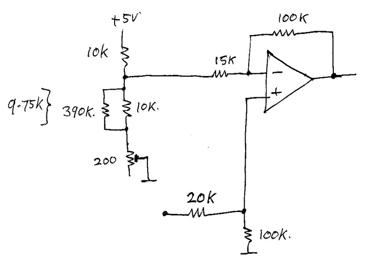

This leads to my next point. The circuit posted by Sig239 overlooked the need to make the Thevenin resistances on the + and - inputs equal. And I missed it also.
So I've drawn the attachment to do this and to use a 100k feedback resistor rather than 50k as I suggested.
The reason the Thevenin resistances on the + and - inputs must be equal is to minimise the thermal drift that would otherwise occur due to changes in the input bias currents when the IC temperature changes. However, this is less of an issue if the op amp has FET inputs.

ljcox said:
R4 is necessary in order to make it a diff amp with minimal thermal drift.
R6 could be eliminated by choosing R1, R2 & R3 such that their Thevenin resistance is = 10k.

It is a cmos device whose input resistance is ">1 terra:eek:hm:" according to the attached data sheet. So if I'm not mistaken, at a couple volts the input currents will be so close to nothing that it does not matter.
Agreed, that's why I wrote that it would be less of an issue with CMOS.
However, it is still necessary to make the Thevenin resistances approx equal since, in the maths, the a + b term is on both sides of the equation and cancels out. So it leads to the simple expression Vo = V1 - V2) a/b
In this case, a = 100k and b = 20k.
