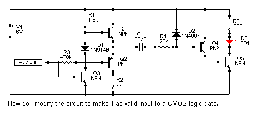

anyways. What I have going is my superregen that produces a visual output based on the incoming signal. The schematic shows the circuit without the superregen portion which connects to the input.
The problem I am having is that I cannot get the input of a 4077 XNOR gate to recognize the signal. The gate always takes the input as a logic "0".
I tried connecting the logic input to the collector of the NPN where the LED's cathode is.
If I reduce the 120K resistor, the output could be stuck at "1".
I think there is an equation with the resistor and capacitor in series that I don't know about.
I want to use my working PLL with this circuit to detect pulses.
How can I do it?
I want it so that when the transmitter outputs a logic high, I want the XNOR input to be a logic high.

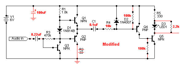

Hi MStechca,
I modified your circuit and maybe it will work better:
1) An input cap is added to keep Q3's bias from being messed-up.
2) Your Q1 to Q3 amp is great but surely only Q3 would do the same job.
3) R2 is removed since it doesn't do anything.
4) The value of C1 is increased a lot to pass low frequencies.
5) The value of R4 is reduced to avoid attenuation.
6) 100k resistors are added to make sure that Q4 and Q5 turn off and fairly quickly.
7) 2.2k is added across the LED to make sure the output goes to a logic high.
8) An important supply bypass cap is added.

I didn't bother adding a resistor between Q4 and Q5, with a high signal level the smoke will be awesome! :lol:
haha :lol:
thanks. I'll see if it works.
He's not joking, I would insert a 3k3 between the C of Q4 and the B of Q5.
Also, Q3 is configured as a transresistance amp. so its input resistance will be low. What is the output impedance of your audio source?
Why would there be smoke coming out when the current supplied to the base of the PNP is well under 100mA?
You are correct! :lol: Almost.
If R4 is 10k then it will have a max of 1.5V across it, supplying 150uA as base current for the PNP. If the PNP is a 2N3906 with a typical current gain of 135, its collector current is "only" 20mA. The NPN should be able to withstand "only" 20mA into its base. The battery won't like the wasted current.
Audioguru, your resistor-capacitor values did NOT help. In fact, they made my LED stay on forever at full brightness.
Your circuit has an input cap to the rectifier so there is no way the LED will stay on unless the capacitor or transistors are shorted or another signal continues to be rectified when the signal is off!
Isn't the receiver a super-regen? Doesn't a super-regen oscillate all the time? Won't the oscillation be rectified and keep the output low?
I think your super-regen is missing a lowpass filter on its output.

I think your super-regen has a squegging oscillation where it builds up its gain due to positive feedback then the moment it oscillates it gets cutoff and builds up its gain again. The squegging occurs at an ultrasonic frequency that you can't hear. The ultrasonic frequency is rectified by your rectifier which turns on the LED. Your supre-regen needs a lowpass filter at its output to reduce the ultrasonic frequency, passing only the modulation.

With a capacitor-coupled rectifier feeding a single transistor, the sensitivity will be reduced since a single transistor has much less current gain than two cascaded transistors like before. A single transistor will work the same as two cascaded transistors before if its the resistor feeding the rectifier is reduced, and its coupling cap increased, since your audio amp is able to drive a low resistance.

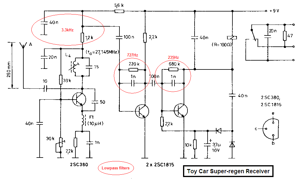

Here's a super-regen receiver for a toy car. It has 3 lowpass filters.
Look at where you circled 727Hz
I constructed a stage like that, except that the capacitor is connected from base to ground. My resistor is 470K and my capacitor is 33nF.
Since your capacitor is from base to ground, it isn't in the negative feedback loop like this one. A capacitor from base to ground forms a lowpass filter in combination with the resistor driving it, the collector resistor of the stage ahead of it. The low impedance of a transistor's base increases the calculated frequency of the resulting lowpass filter.
