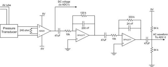

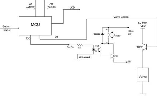

I'm trying to build a digital blood pressure measuring device.the circuit diagram is given as a thumb nail.But the problem is that in India I can't find the pressure sensor mpx 2050 .So there any replacable pressure sensor available in India.
