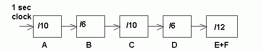

Does anyone have any schematics of a digital clock design? ( Secs. Mins. and Hours) I wanna see exactly how each one is clocked by one another. I have to display seconds, minutes, and hours. I am designing this on Altera Max Plus.
thnx
If you want to use TTL or CMOS chips, it's all same.
You have bunch of counters that are cascaded.
First you have counter for 10 (seconds),
then you have it's output going into counter by 6 (seconds x10),
then this goes to another counter by 10 (minutes) then its
output goes into one more counter by 6 (minutes x10) etc.
If you look at clock, you see format HH:MM:SS but in reality
signal goes from A to B to C to D to E to F in reversed
order FE:DC:BA (it's from right to left).

I've already designed the seconds using binary counters (mod 6 and Mod 10 ) each going into 7 segment displays. The "seconds" design was succesfull, i clocked it with 1hz. and it did the expected operation ( 0-59)
The "minutes" design will be the same as the "seconds" except im kind of confused as to how do i make the "seconds" clock the "minutes"
ok so, the output of the mod-6 counter ( for the seconds) goes into the input of the mod-10 for the minutes counter, then to the six, and the output of that into the hours?
You need a carry signal that changes when the seconds counter increments from 59 to 0. Use this to clock the minutes counter.
You may need an inverter. eg. if the minutes counter needs a positive edge, and the seconds carry signal is a negative edge, you will need an inverter.

Note that decoding for hours is a bit different. The highest digit ("F") can be decoded using AND gate of bits 1 and 3 (assuming you have 4-bit counter with outputs Q0-Q3). Buffer bits 1 and 3 that go to 7-segment decoder and use the signal from the AND gate we just mentioned
to switch them to "0".
Yes
If you use same type of counters, you don't have to worry about this.
They all should be clocked with same edge. If you want to play safe,
breadboard it and experiment. This is always safest approach.
Digital clock
The most significant bit of the seconds counter will change from high to low when the count changes from 59 to 0. Use this as the carry signal.
So if the minutes counter increments on negative edges, then you don't need an inverter.
