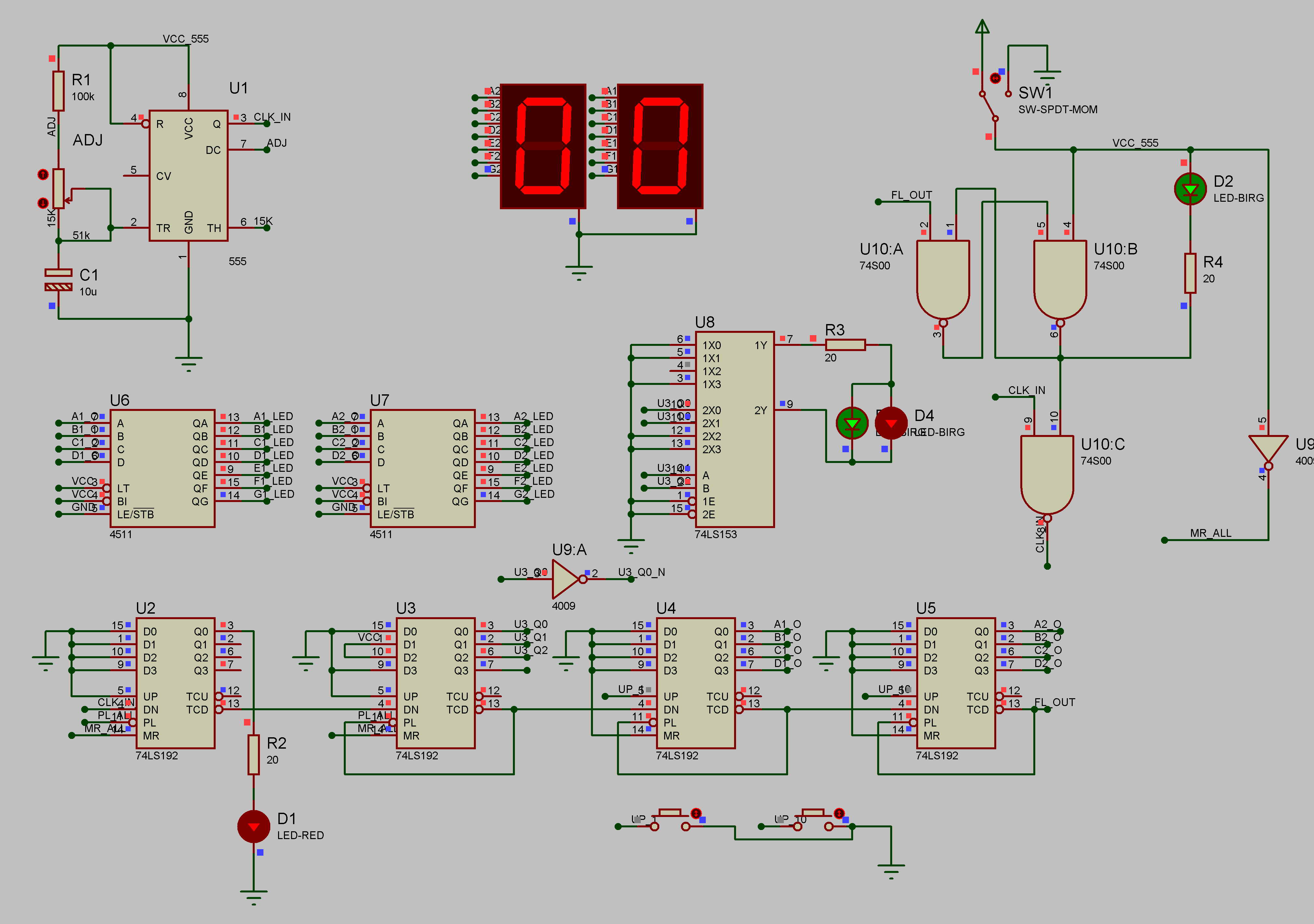

Please, i need the circuit of a digital alarm clock with days of the week on its display as well. Thank you.
use NE555 to generate the 1 second clock
and many 74LS194 (s)
display with 4511s drive
Maybe the following picture would be a little useful(a easy washer controller with digital circuit)..

Sorry but using the 555 as a timebase is a bad idea because it's not very accurate or sable, typical capacitors have a tolerance of 10% or worse so a second could really be 0.8s or 1.2s meaning it'll gain or loose a couple of hours every day.
YES,You're right. sorry.
I haven't thought much of this problem.The clock should be run for a long time,the timebase must be accurate..
And which kind of timebase generator will be ok?
A crystal and a frequency divider can be used.
I'd recommend an 32768Hz crystal because they're cheap and can be bought from most component sellers or be taken out of old watches.
A CD4060 and CD4013 can be used to make a 1Hz timebase.
