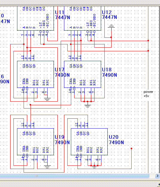

I cant use a microcontroller.
Ive worked on it a bit more and i think i got the "seconds" portion down but i need to create a 60hz signal to connect to pin 14 on the first 7490 correct?
How can i do this? I read using a 555 timer is inaccurate and that i should produce it using a crystal? How do i go about doing this?
I attached the part for the seconds. Is that correct?

You need an accurate 1 Hz signal. A 555 is not accurate enough. There are 3 obvious frequency references that are accurate enough.
50 or 60 Hz mains. The mains signal can be transformed to a safe voltage and then divided by 50 or 60 to give 1 Hz
32768 Hz watch crystal. You need a simple oscillator circuit followed by a divide of 32768. There are lots of ICs that will divide by that.
A higher frequency crystal. Again, a simple crystal oscillator, followed by a suitable divide. That may take more ICs.
Your circuit to divide by 60 looks OK. Do you want the displays connected to the 7447s in your diagram to show minutes or seconds?

Can you give me a diagram please? Also im simulating this in multi sims. Does it have crystals in its database?
I also have to make this run off a 9v battery. I have to reduce it down using a 7805 though correct?
I have the displays connected i just couldn't fit it in the screen shot. The 7 segment displays are connected to the corresponding pins on the 7447's. I have to run a 220ohm resistor in between each though correct?
